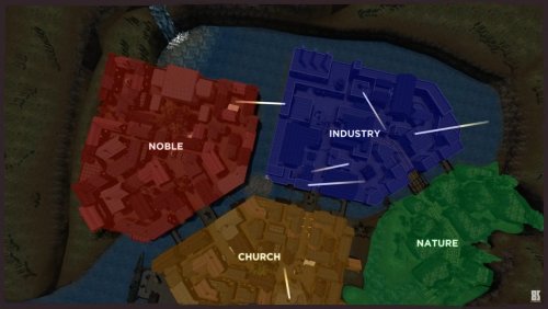

For the concept to properly work, the map had to be completely flat, because upwards and downwards movement would definitely cause visual glitches in the movement animation of Stiglitz.
The layout of this map is divided into 4 sections: Noble, Church, Industry and Nature.
This was done to have chokepoints that Stiglitz needs to be escorted through, while still providing several alternative routes.

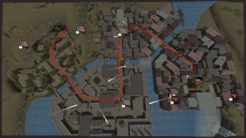

This map has one primary objective (extracting Stiglitz), one secondary objective (Command Post) and two flag spawns.
Stiglitz:    Stiglitz can be escorted by both teams along the spline path. Allied forwards and Axis backwards.
CP:            Aside from the usual CP benefits, the command post is also responsible for showing Stiglitz on the command map. If you do not own the command map, you don't see his position.
            Already in this version this is a rather big advantage, but with free escort movement this will basically be game deciding.
Flags:        The flags are located on each of the middle islands and make team communication necessary to avoid enemies falling into your back.
