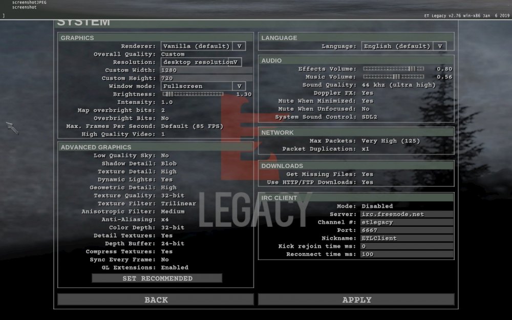

in game this is my default settings

The echo sound is common with sound frequency being to low if your is set to 22khx then just up it to 44khz which is ultra high
