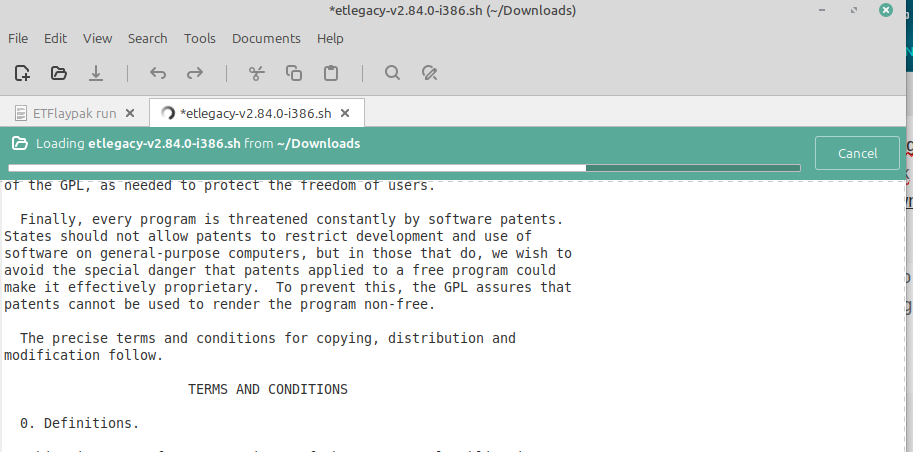

Thank you for replying, I am admittedly the worst of the worst here being an old windows guy trying to learn linux to breath life into my HP nvidia laptop.  I've gone to that web site and did the download and I have no idea what to do with this once it opens in the text editor (remembering what it was like learning DOS in 1986 again).  What happens next?
scroll down and acept the terms. press page down
