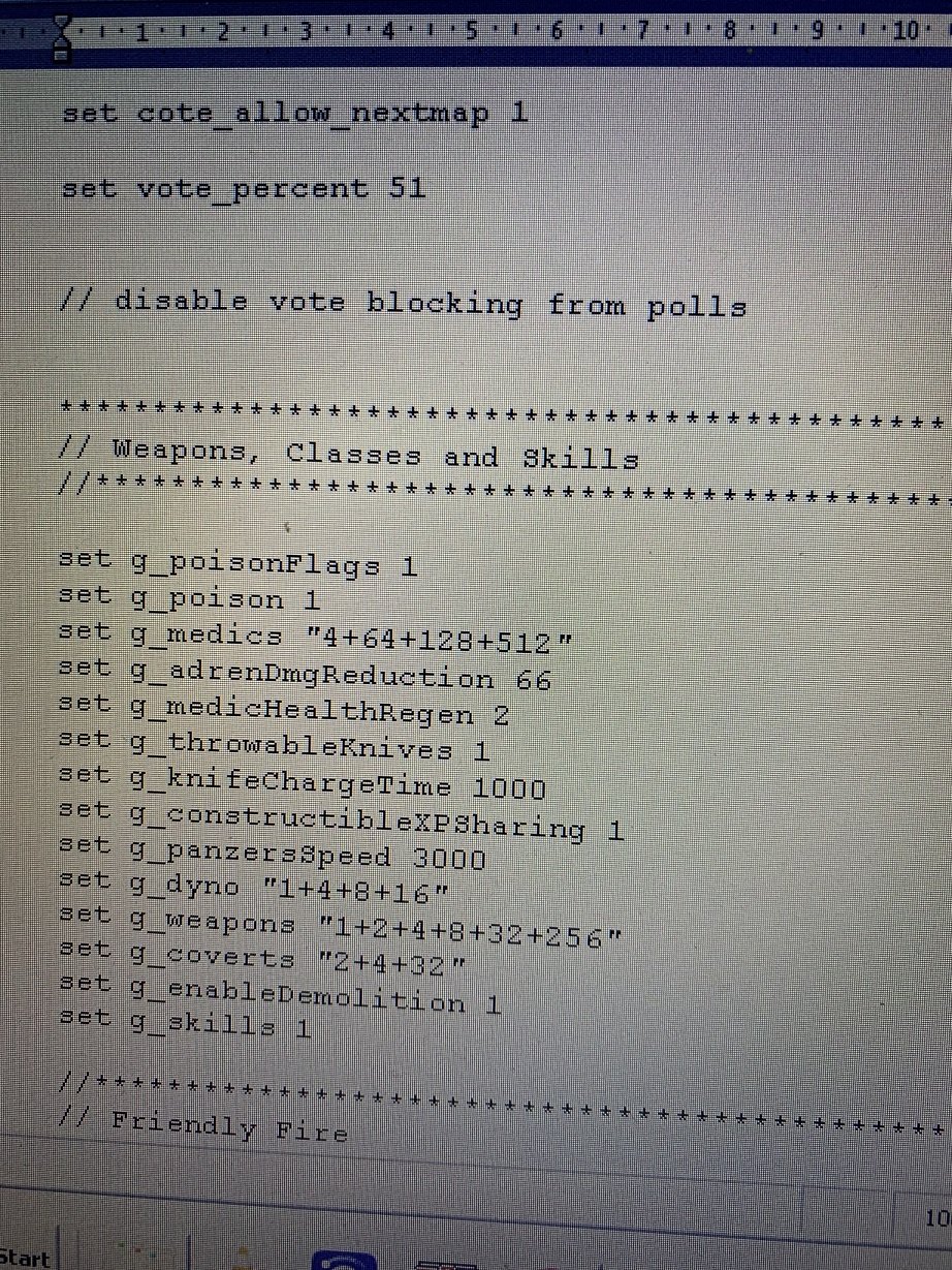

I have a big Problem with the silent.cfg. I worked with your great WIKI
and the problem is :
whenever i will set more numbers  for a set (ex. g_weapons 1+2 etc) they does not work on the server.
what is the correct art of typing multiple numbers so that they work ?
Big Thanks

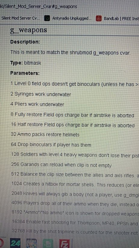

but if i remember correctly, u need to combine the parameters like 1+2+4+8+32+256=303
so g_weapons "303"

just to double check , write in console /rcon g_weapons , what value do u see?
it says g_weapons is "303" default is "0"
But there are absoltutely no Changes! For ex.: It should include that syringe and pliers work under water .. NOPE
Edited by Destruction
3 hours ago, Destruction said:
THANK YOU
In Game /rcon set g_... worked
Merci
