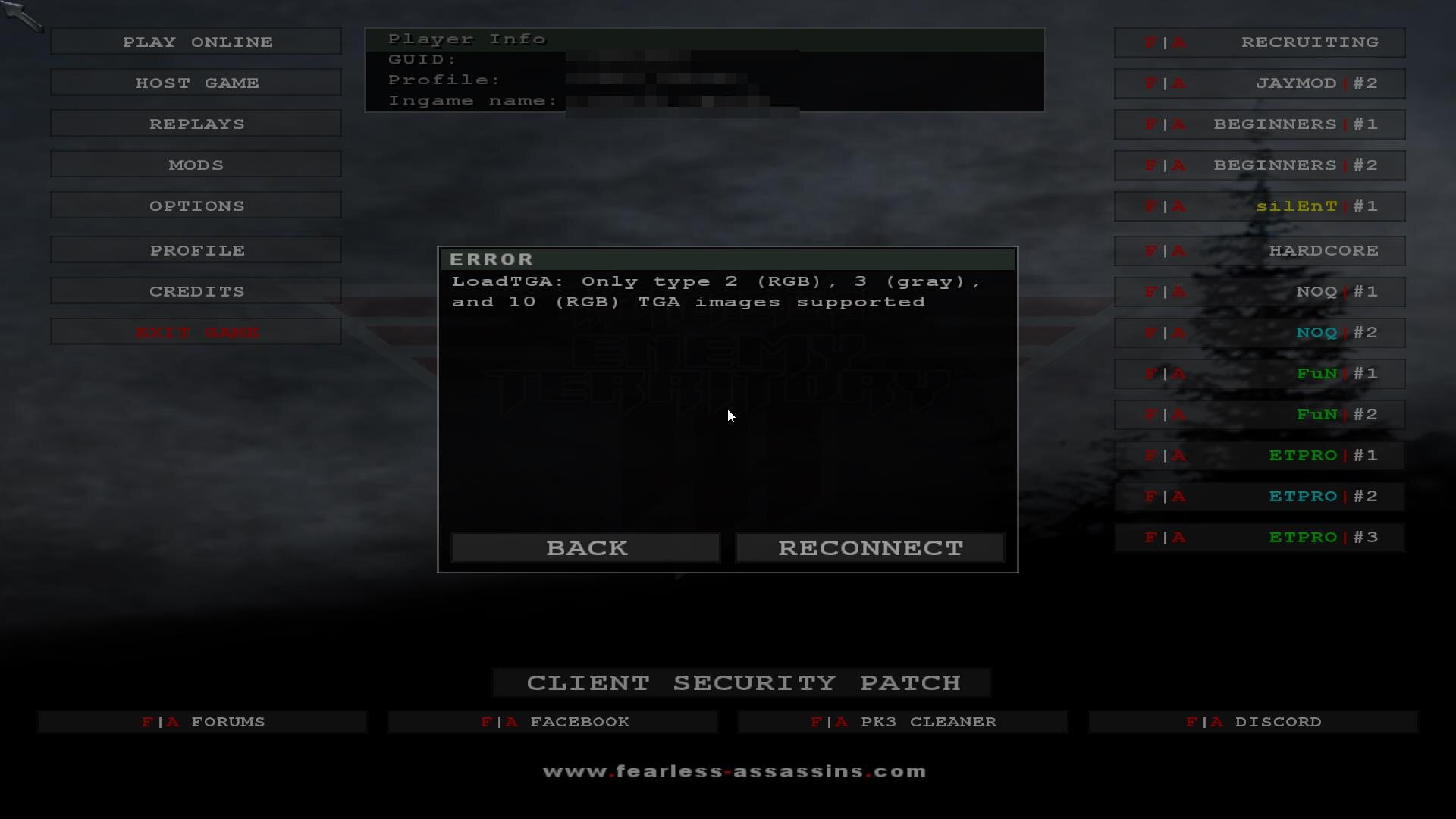

Hi gentleman,
As you can see I have the following issue above, since lately. Just popped up and cant connect to Recruiting, but to all other servers. Already deleted profiles and server caches in jaymod and etmain, as well all drivers are up 2 date.
Any clue?

It looks like that specific error statement has been popping for many games, for at least the last 18 years.  😄
Can you connect to the other FA Jaymod servers, just as "Jaymod #2" and "Beginners #1"?
There might be corruption within a TGA file within a PK3 file.  :hmm
What ET version, and OS version do you use?  Do you access ET via Steam?
this is the first time i see this kind of error lol, but it looks like you downloaded some shit-pk3 from somewhere hence its affecting your client.
i didnt understand here if you meant that you deleted "jaymod" and "etmain" folders or you cleared the pk3s inside them ?
anyways i would suggest fresh new installation and be careful what servers you join and what packs you download :)
if you dont have ETLegacy yet i suggest you download it here
IMPORTANT save your guids in order to save your stats and levels in all servers (etkey and guids)
I wonder if he could just run our "PK3 cleaner"? @Noir
i have never tried pk3-cleaner but i assume it deletes all useless .tmp file formats and costum pk3 files.
reinstalling the game is always best option for me since its a small-sized game and can be installed in few seconds 😄

I installed ET legacy, now everything works like a charm
very good and everyone should too 😄
