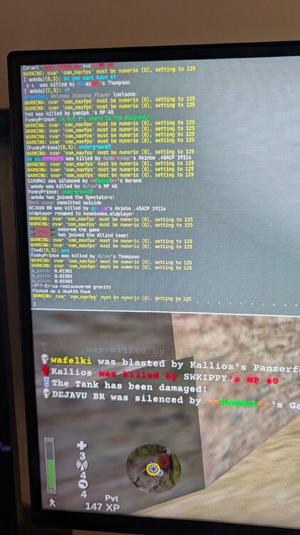

Platinum VIP -=HipKat=- Posted November 7, 2024 Platinum VIP Posted November 7, 2024 (edited) Can anyone tell me why I see this on ETL Servers?? FWIW, this is com_maxfps from my CFG: bind p "com_maxfps 71" bind z "com_maxfps 150" seta com_maxfps "250" This one may be the issue, now that I look at my CFG bind SPACE "+moveup;com_maxfps 250" Also not sure why those values are set to 250 instead of 150 or 166 Edited November 7, 2024 by -=HipKat=- Quote
yaku Posted November 8, 2024 Posted November 8, 2024 (edited) Do you get same messages on FA Legacy servers? Try on our US server: etl2.clan-fa.com:27950 Plus just FYI: FPS tricks are fixed on legacy mod, nevermind amount you set, 71, 90, 125 or 666 - jumps and recoil are exactly the same on every value. Edited November 8, 2024 by yaku 1 Quote
Platinum VIP -=HipKat=- Posted November 8, 2024 Author Platinum VIP Posted November 8, 2024 (edited) 5 hours ago, yaku said: Do you get same messages on FA Legacy servers? Try on our US server: etl2.clan-fa.com:27950 Plus just FYI: FPS tricks are fixed on legacy mod, nevermind amount you set, 71, 90, 125 or 666 - jumps and recoil are exactly the same on every value. I get it on all ETL servers, TM, Hirntot and FA but I'll edit those binds out on my ETL CFG, thanks man! Edited November 8, 2024 by -=HipKat=- Quote
LarrY Posted November 8, 2024 Posted November 8, 2024 Mmmhh problem might be in the command +moveup in my cfg i have something similar to change the crosshair size while crouched -> as long as mouse2 is clicked crosshair is smaller on release the crosshair goes back to the original size try doing the same for the moveup, create the jump/nojump variables and bind the spacebar to alternate (+vstr) between the 2 set down "+movedown; cg_crosshairsize 40" set up "-movedown; cg_crosshairsize 50" bind MOUSE2 "+vstr down up" for the maxFps instead i've set them to change depending on the weapon selected: bind 1 "weaponbank 1;com_maxfps 250;m_pitch 0.01800" // Selects knife bind 2 "weaponbank 2;com_maxfps 71;m_pitch 0.01800" // Selects pistol bind 3 "weaponbank 3;com_maxfps 250;m_pitch 0.01600" // Selects MSG bind 4 "weaponbank 4;com_maxfps 250;m_pitch 0.02200" // Selects grenade all these lines work on ETL clients and servers (other mods included) 1 Quote
Platinum VIP -=HipKat=- Posted November 9, 2024 Author Platinum VIP Posted November 9, 2024 I'm going to apply those. Great ideas! Quote
Platinum VIP -=HipKat=- Posted November 10, 2024 Author Platinum VIP Posted November 10, 2024 On 11/8/2024 at 7:42 AM, LarrY said: Mmmhh problem might be in the command +moveup in my cfg i have something similar to change the crosshair size while crouched -> as long as mouse2 is clicked crosshair is smaller on release the crosshair goes back to the original size try doing the same for the moveup, create the jump/nojump variables and bind the spacebar to alternate (+vstr) between the 2 set down "+movedown; cg_crosshairsize 40" set up "-movedown; cg_crosshairsize 50" bind MOUSE2 "+vstr down up" for the maxFps instead i've set them to change depending on the weapon selected: bind 1 "weaponbank 1;com_maxfps 250;m_pitch 0.01800" // Selects knife bind 2 "weaponbank 2;com_maxfps 71;m_pitch 0.01800" // Selects pistol bind 3 "weaponbank 3;com_maxfps 250;m_pitch 0.01600" // Selects MSG bind 4 "weaponbank 4;com_maxfps 250;m_pitch 0.02200" // Selects grenade all these lines work on ETL clients and servers (other mods included) So I removed com_maxfps 250 from the space bind. Edited to how you have your weapons assign maxfps which is AWESOME when I change weapons as sniper to go back to maxfps 250 again and I removed my binds for Z, but I still have the error in Console, Which doesn't seem to affect game play at all. I didn't add your xhair size binds, btw. My mouse button bind for that is MOUSE4 which is written differently than yours. I assume you have to hit MOUSE2 again to stand up. mine stands up when I let go of the button bind MOUSE4 "+movedown" 1 Quote
