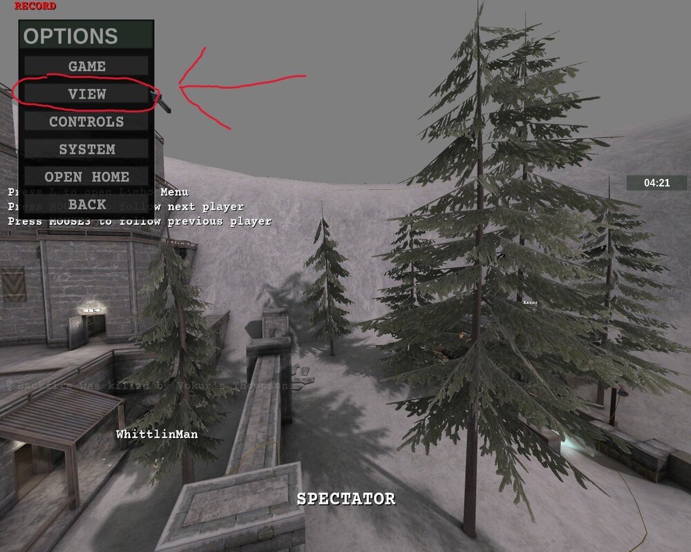

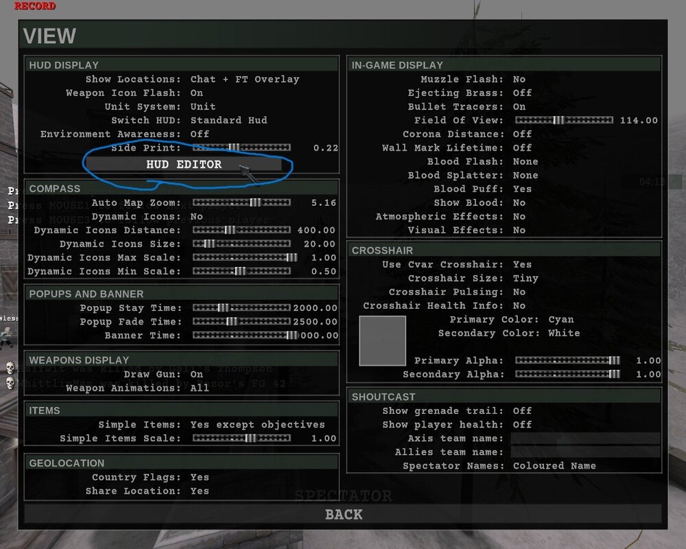

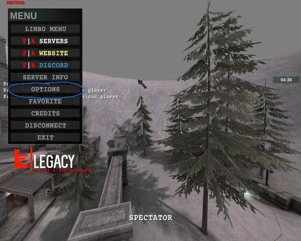

Esc>View>Hud Editor

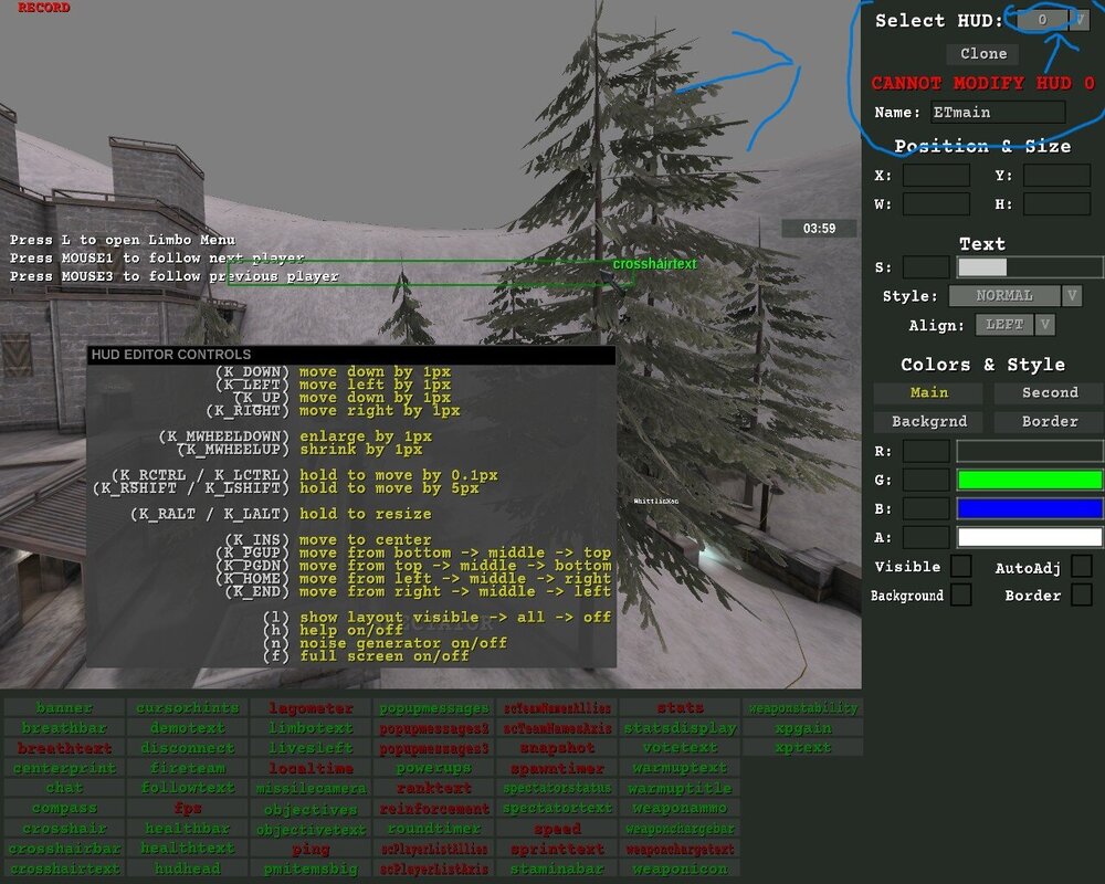

From this point you need to navigate to the upper right corner and click "Select Hud" pick a number, (I would start with 1). This is because you cannot modify the original hud (Hud 0)

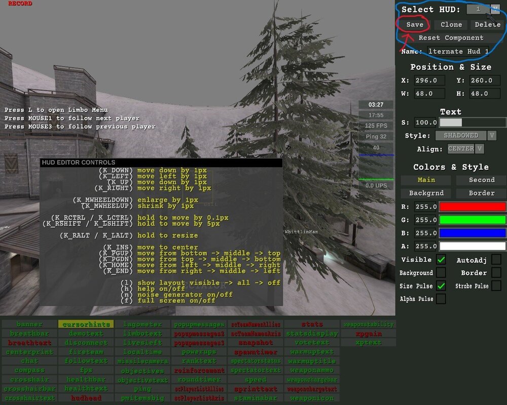

There is a general key that shows you what buttons do what and how to toggle things on and off. You can also click and drag things to desired location along with the sizes of everything as well.
Do not forget to hit save!

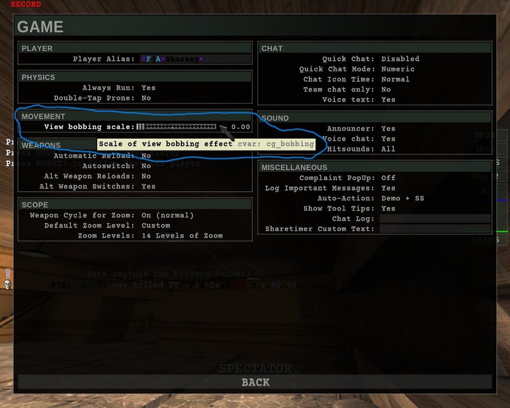

Another thing you may want to do is back to the options menu, go to Game, and slide the "View Bobbing Scale" down to 0. Alternatively you should be able to do "/cg_bobbing 0" as well.
