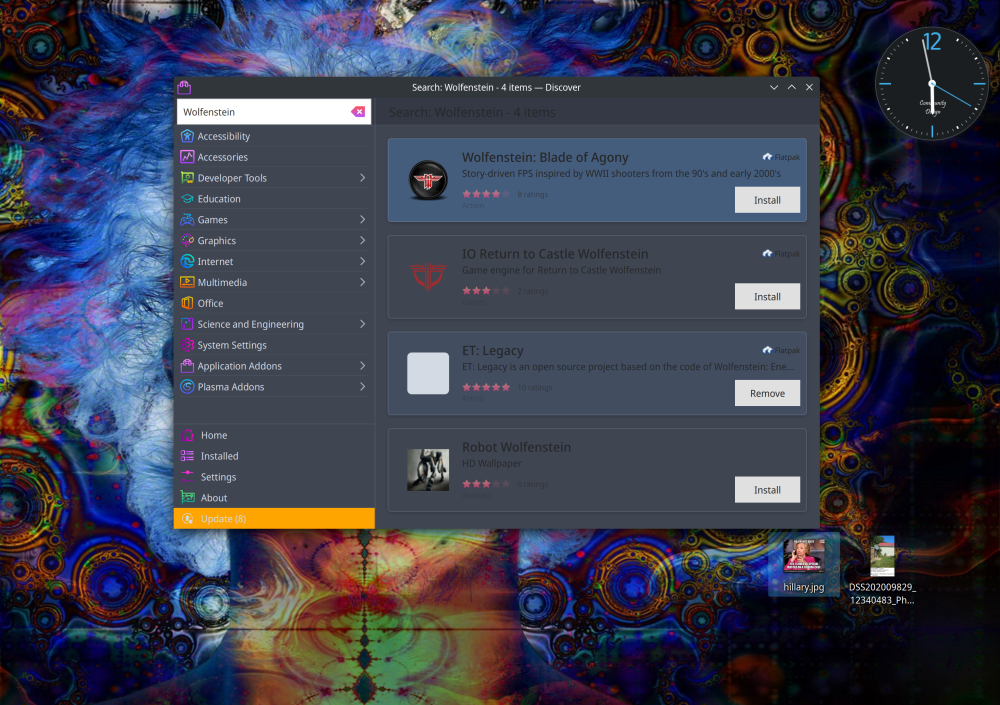

Or, for Legacy, search Wolfenstein in Discover app
