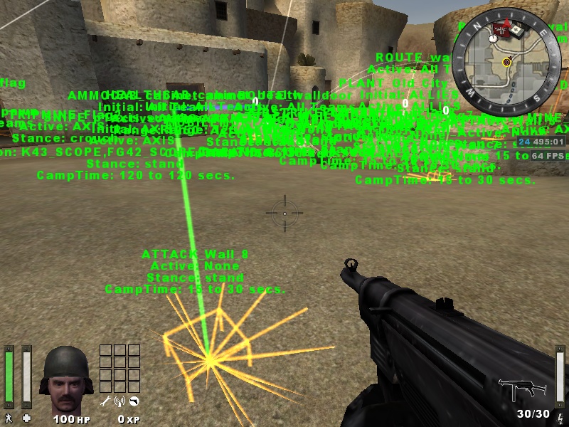

1) Using the in-game omni-bot menu, select the 'create camp goals' option.
2) Create an 'Attack' goal.
3) Name your goal something appropriate. In this example, we'll call it 'Wall_8', as it is the 8th goal we're creating near the old city wall.
4) You can use the omni-bot menus to adjust the 'stance', such as stand or crouch. We'll leave this one as 'stand'. You should now be able to see your goal:

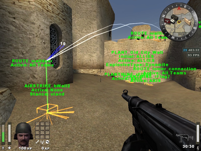

1) Use the in-game omni-bot menu to create a weapon goal, then select airstrike
2) Stand in the position and aim where the airstrike marker should be thrown, and select 'add facing'
3) Add additional facings if you like. Omni-bots will choose one at random. In the below example, we've added two facings:
Remember to enable / disable these goals for the appropriate teams when require in the script. This is the exact same process as enabling / disabling attack / defend goals.
