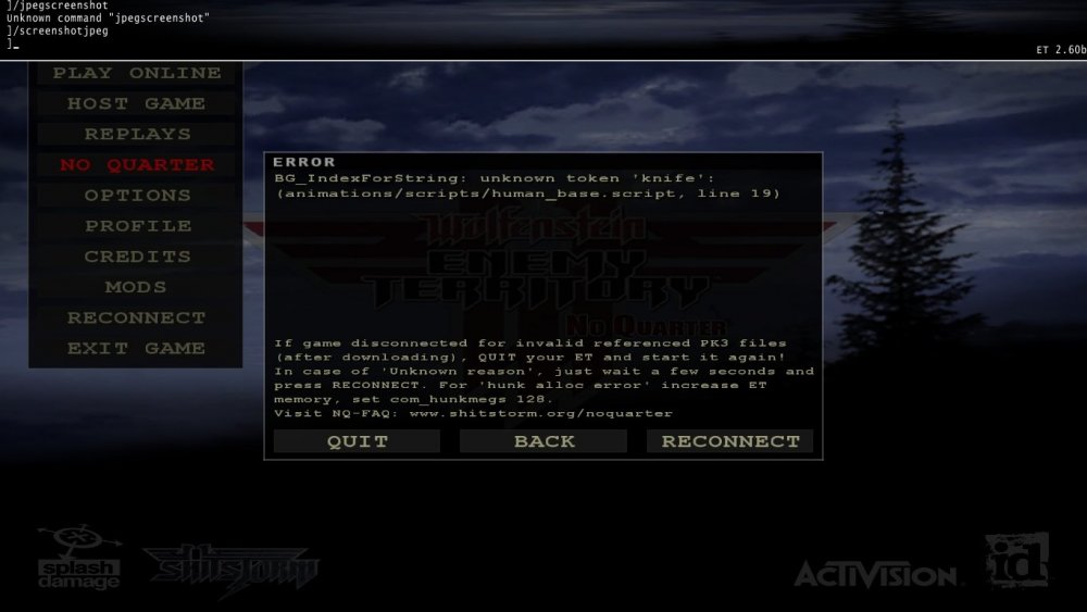

Im trying to test out the Revolution Mod for NQ in my localhost server, but I keep getting the same error every time.
Can someone help me out in this matter?
Does the revolution mod run on 1.2.9??
I ask this as the revolution mod constantly refers to the "NoQuarter" folder which was only used up to build 1.2.3. The revolution mod also mentions 1.2.3 in the change log, i'd assume if it was made for anything above 1.2.3 it would reference the higher builds instead???.
1.2.7 and 1.2.9+ use an "NQ" folder and not a "NoQuarter" one.
