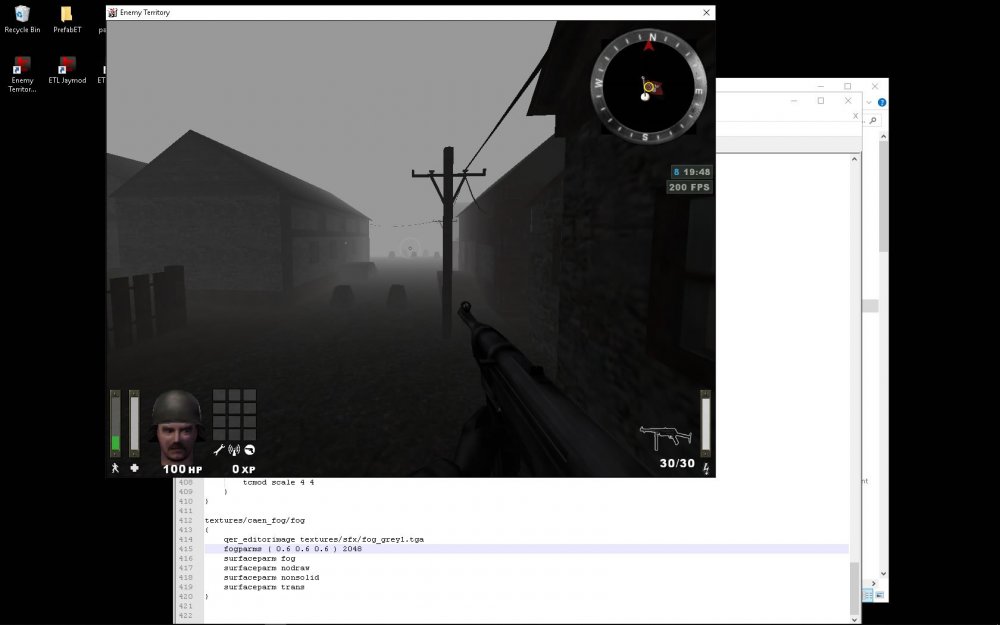

Trim down did a little but still had to pull fog down from 3072 to 2048 to get it stable fps

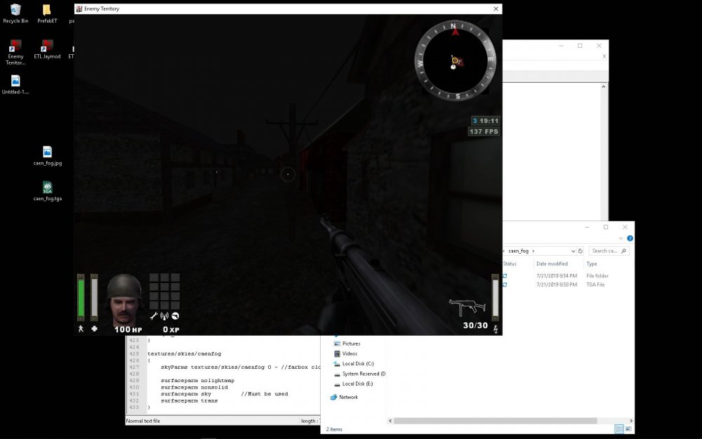

just a idea take away the  fog and make it nightime  see if that  up the fps
It has to have added fog to drop the fps already tried all the methods to cut corners

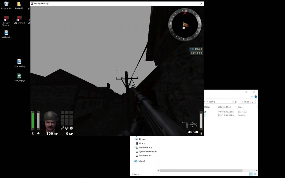

This is with sd_goldrush sky falls back to flapping fps at 60
same thing with fueldump and battery sky

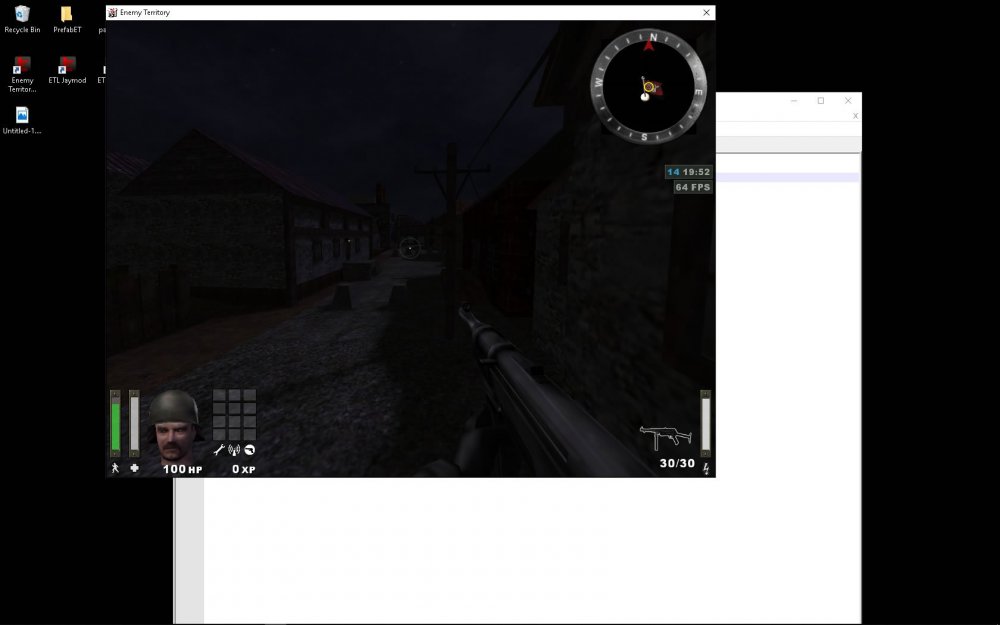

Have tested with finalbuild compiler (simulate old style -light -extra)
If I could only remember how to cull visible distance with out fog that has slipped my mind

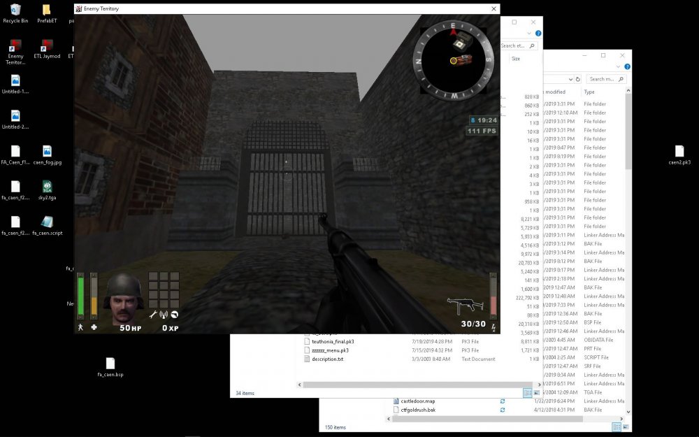

Okay got it down to a sky shader what you think it's got a cull effect it's got a little bit of range cut off like if your standing at the tank you can't see allies spawn that eliminates at least some extra entities from rendering don't mind my fps Im on a low end gpu card
The area can be lite up a bit with _minlight it is a 15 at the moment there is a sun light used from battery sky but the _foghull effect removes the sky unlike _fogclip this is backwards instead of ranging the fog from the player it ranges it from the sky

This is just to show the cull distance if that is okay

this looks really really nice i played on a  night diversion of this map a  long long time ago and ya i  agree adding  in some lights would really make this map pop
