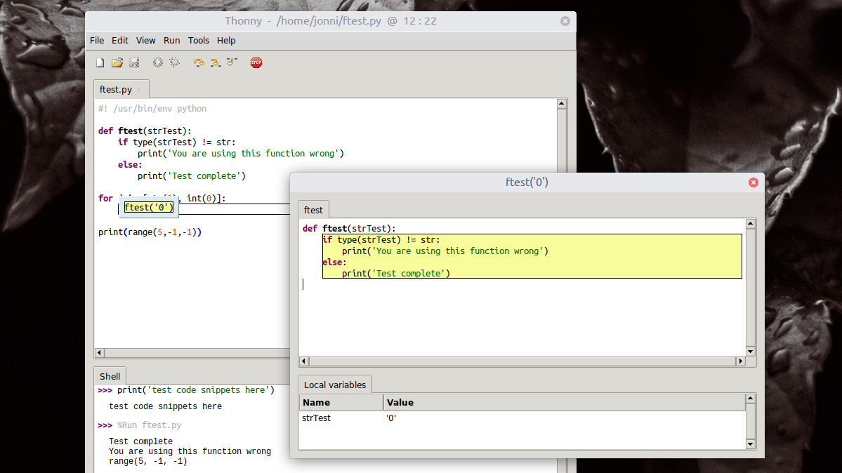

Thonny is the least ‘developer-centric’ of all the IDEs we’ve highlighted here, but that doesn't mean it's any less powerful. It's developed at the University of Tartu in Estonia, and is itself written in Python. It features a powerful debugger that's great for learning the ins and outs of coding without worrying about how breakpoints work.
The debugger can show you the state of variables as the program runs. It lets you take small or large steps through the program, which is great if you’re tracking down hard to find bugs. This is much better practice than – as beginners and seasoned coders alike are occasionally tempted to do – peppering your code with messy print() statements.

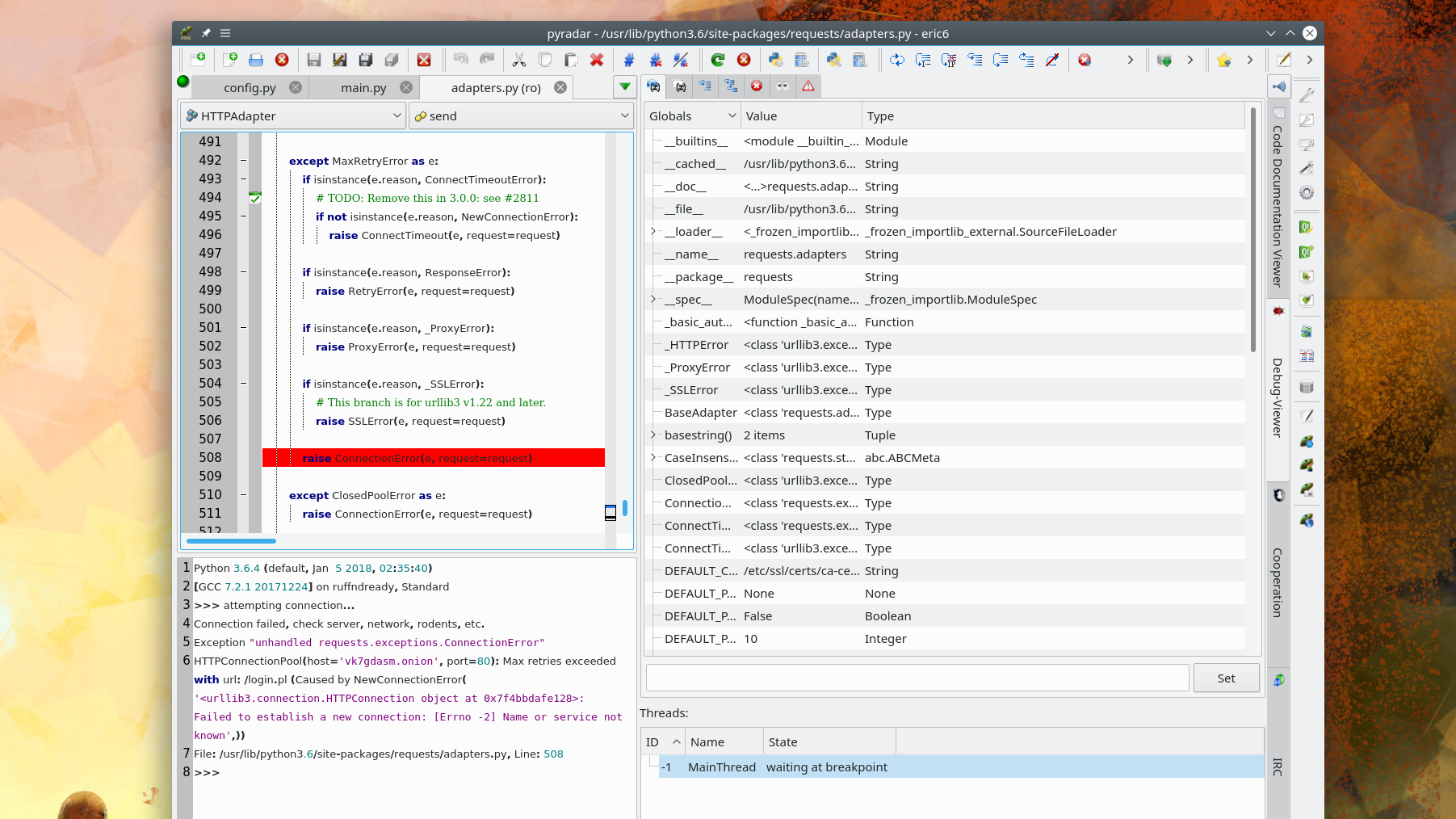

This powerful cross-platform IDE – which, like IDLE, is named after Eric Idle – is written in Python and uses the Qt library. Though Python is its focus, eric (lowercase is the intended spelling) has excellent support for Ruby, and other languages too. It supports the bread and butter tasks we've come to expect: code folding, code completion, brace matching.
But there's so much more that you'll need to use its built-in (and automated) TODO list generation to keep track. It has an integrated class browser and powerful debugger, and thanks to being built-in Qt supports building GUIs via Qt Designer. The initial configuration screen may seem daunting, but most of it can be put off till later.
While the interface does look busy, there's no reason you can't use eric as a simple code (or even plaintext) editor. But it really comes into its own for more serious coding – there's even a built-in hex editor, SQL browser and icon designer. It supports unit tests and can debug both multithreaded and multiprocessing programs, which as anyone who dabbles in such things will testify, generate the worst kind of bugs.
It supports Mercurial and SVN version control natively, and Git support is available through a plugin. Like Code, there's support for real-time collaboration on code. In short, if you want a feature-rich Python powerhouse, eric is for you.
