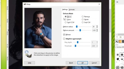

iWarp for GIMP - deform options
iWarp for GIMP gives you plenty of options for warping and twisting your photos
Open your image in GIMP and use the Scale tool to shrink it to a size suitable for sharing on social media. Now click 'Filters > Distort > iWarp' and you'll be presented with a preview of your photo, along with six options:
  • Move, which shifts a part of the image in the direction you click and drag
  • Remove, which reverses any distortions you've applied
  • Grow, which expands the area you click
  • Shrink, which pinches the area you've clicked inwards
  • Swirl CW and CCW, which twist the image clockwise and counterclockwise respectively, creating an effect like swirling a brush through paint
These effects are applied by clicking and dragging on the preview window. There's no zoom option, but Deform Radius lets you choose the size of the area to be distorted and Deform Amount changes the strength of the effect.

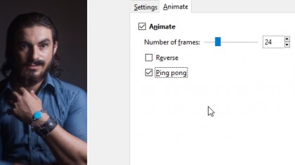

iWarp for GIMP - animation
Select the Ping Pong setting to play your animation forwards, then backwards in an endless loop
Once your photo looks silly enough, click the 'Animate' tab. You'll probably want to select Ping Pong, which plays your animation forwards then backwards in an infinite loop. Increasing the number of frames will result in smoother animation, but will also increase the file size, and choosing the Ping Pong option will double the number of frames you've specified.
