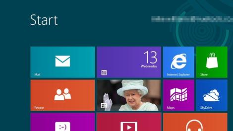

The Start Screen
Log on to Windows 8 for the first time and you'll notice that the Start menu has been replaced by the colourful Start Screen. This looks great, but it works very differently, and you'll soon notice some issues.
The Start menu provided easy access to every aspect of your system, such as search, Windows tools, settings, installed programs, recent documents and more. There simply isn't room to display all of this on the Start Screen, though, and so many functions have now been scattered around the system, making them much harder to find.
After launching Windows 8, for instance, you might want to customise it − but there's no Control Panel tile. The Start Screen does provide some shortcuts, but they're so well hidden that many users will probably only find them by accident (press Win+X, say, or move your mouse cursor to the top-left corner of the screen to launch the Charms bar, and click Settings). And even then they may be disappointed, as plenty of key settings now have to be accessed elsewhere.
