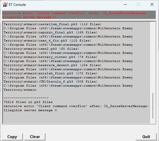

Happens to me as well. The game either completely freezes or shuts off and takes me to the forums.
I got the message "Client Command Overflow" when trying to close the game all together, after it freezes.
Ran a PK3 cleaner, but they were on a different map before I was done.
18 hours ago, RNGesus said:
Did it happen to crash to the console? If so can you post this console?
Different map but same message, hope it helps.

This looks like 2.60b does this happen in ETL?

Can you confirm same console crash? Command overflow?
  • ET Member
I also noticed 75k files loaded from PK3s I would strongly suggest reducing the amount of custom map files in et main. When connecting to a server which you do again on every map load the client sends a configstring and other reliable commands listing its pk3 checksums. Your client is likely generating more than the 256 buffer can handle and the server can’t confirm fast enough leaving you with both these errors we see client command overflow and illegible server message
