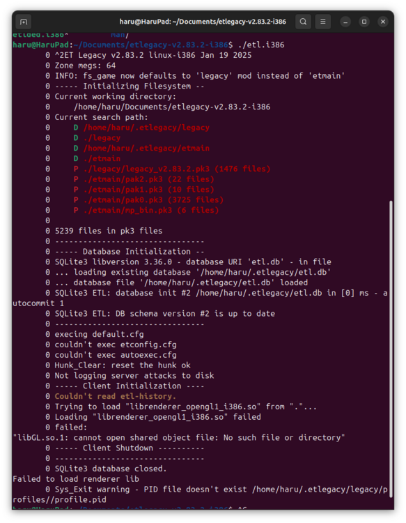

Ran those commands and checked after, all three lib's are now there and the latest version. This did get me one step closer to running the game, it finally gave me some info when it failed!
It still looks like its missing libs.. :hmm
Maybe try:
sudo apt install libglu1-mesa:i386 libSDL2-2.0-0:i386
  • 100 3

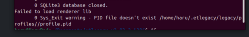

Seems like the main profile is missing, according to this. Maybe try importing an existing one.
Seems a well detailed full install for ubuntu: https://help.ubuntu.com/community/Wolfenstein%3A Enemy Territory
at least they state very clearly all the dependencies:
libasound2-plugins libdrm2:i386 libexpat1:i386 libglu1-mesa:i386 libgl1:i386 libsdl2-2.0-0:i386
(they showcase with ubuntu 23 ... pretty safe to assume it works with the v24 aswell)
Think the solution for the last bit is what Element said : install the opengl
but check all the others aswell

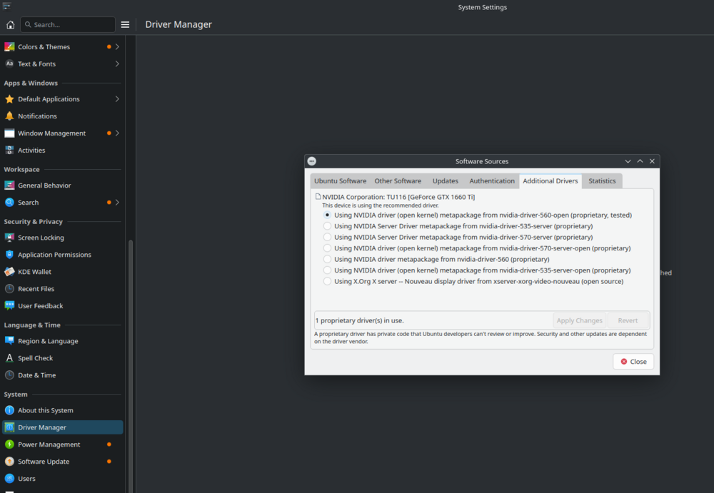

Also check your graphic card driver from system settings ->Driver Manager.
