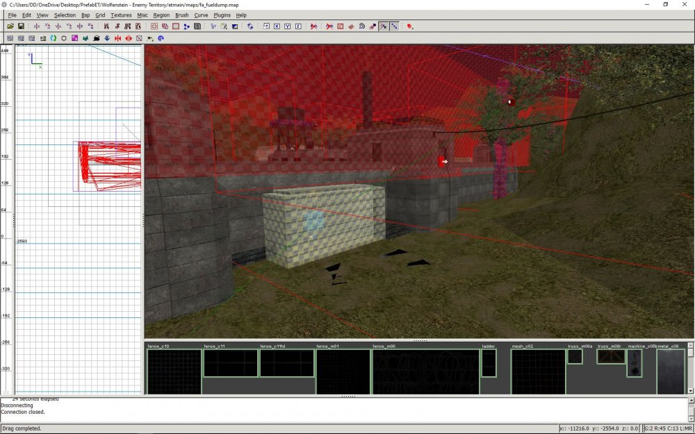

Cause Im still coming up with a high number of entities from calculation 742 would like to have it below 500 if possible see below
func_group and func_static are removed during compile and converted to non-solid brushes

LOL the spline_control count is unreal I found one of the problems
You never use this many they're only for sharp turns and turning around and most times never required really tank doesn't turn that fast

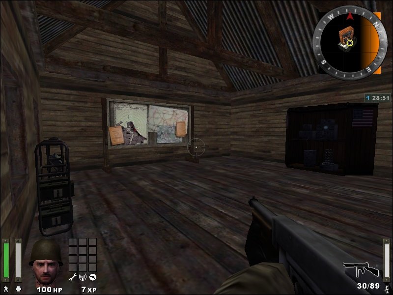

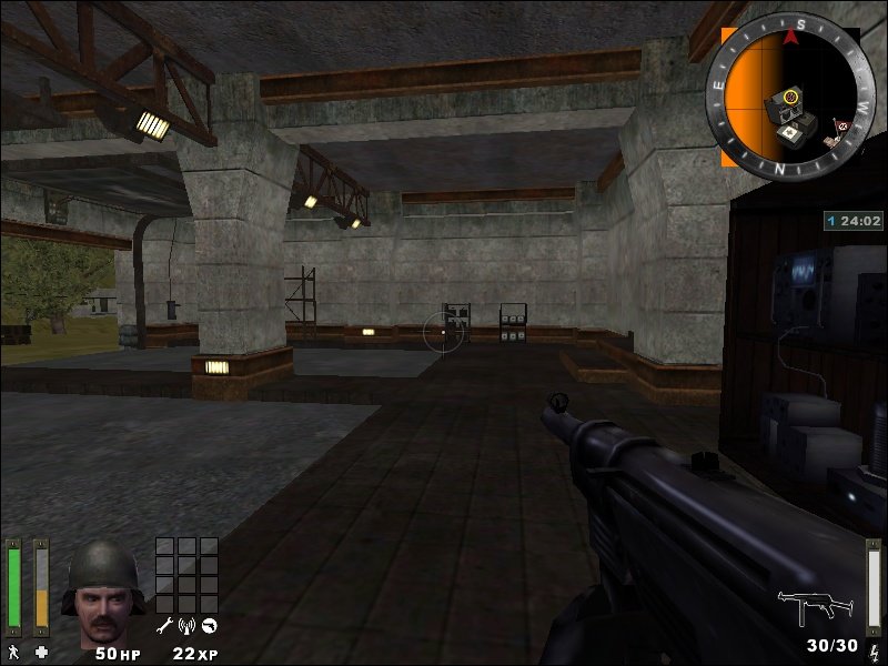

Both CPs now have ammo cabinets will adjust fueldump and add one so both teams will have one at end but the cabinet will not be inside the Depot it will be at the tunnel exit door
This will create a vantage point for both teams to keep it fair play
Allies CP at start
Axis CP at at Fueldump

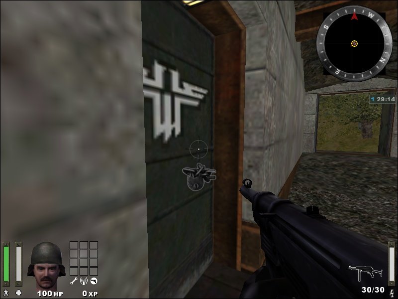

Tunnel Exit door is now sealed to Fueldump only Allies and Covertops can open it

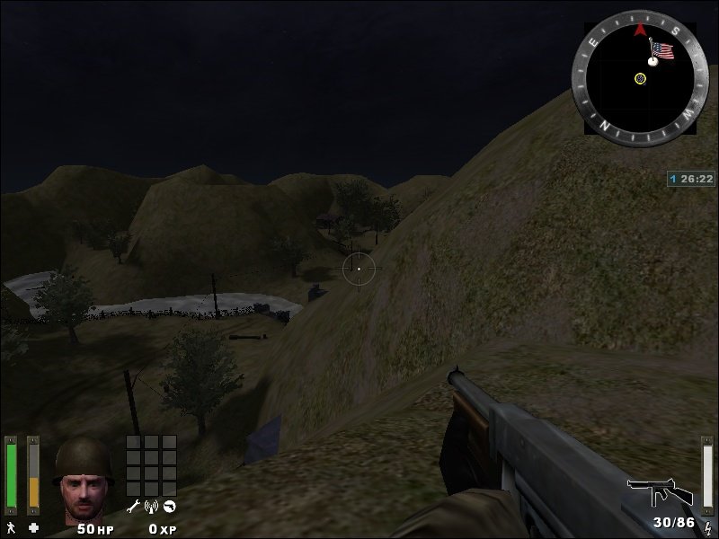

You can get up here now from the backside above the tunnel only small section is open for spectators to go through so they don't have to follow people etc

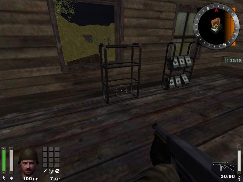

Im still working out some things like this ammo box running out not liking that to much it's got a unlimited rate but it's refresh is so slow
