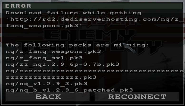

Try to join the server and make a photo even with phone of the screen and send it to us so we see what it says.

In ET 2.60 - after entering the above settings - the game does not even try to download the maps, but simply throws me out of the game into the browser on the server with which there is no connection. How to cancel the CL_alldownload 1 settings?
So that the game itself tries to download the maps.

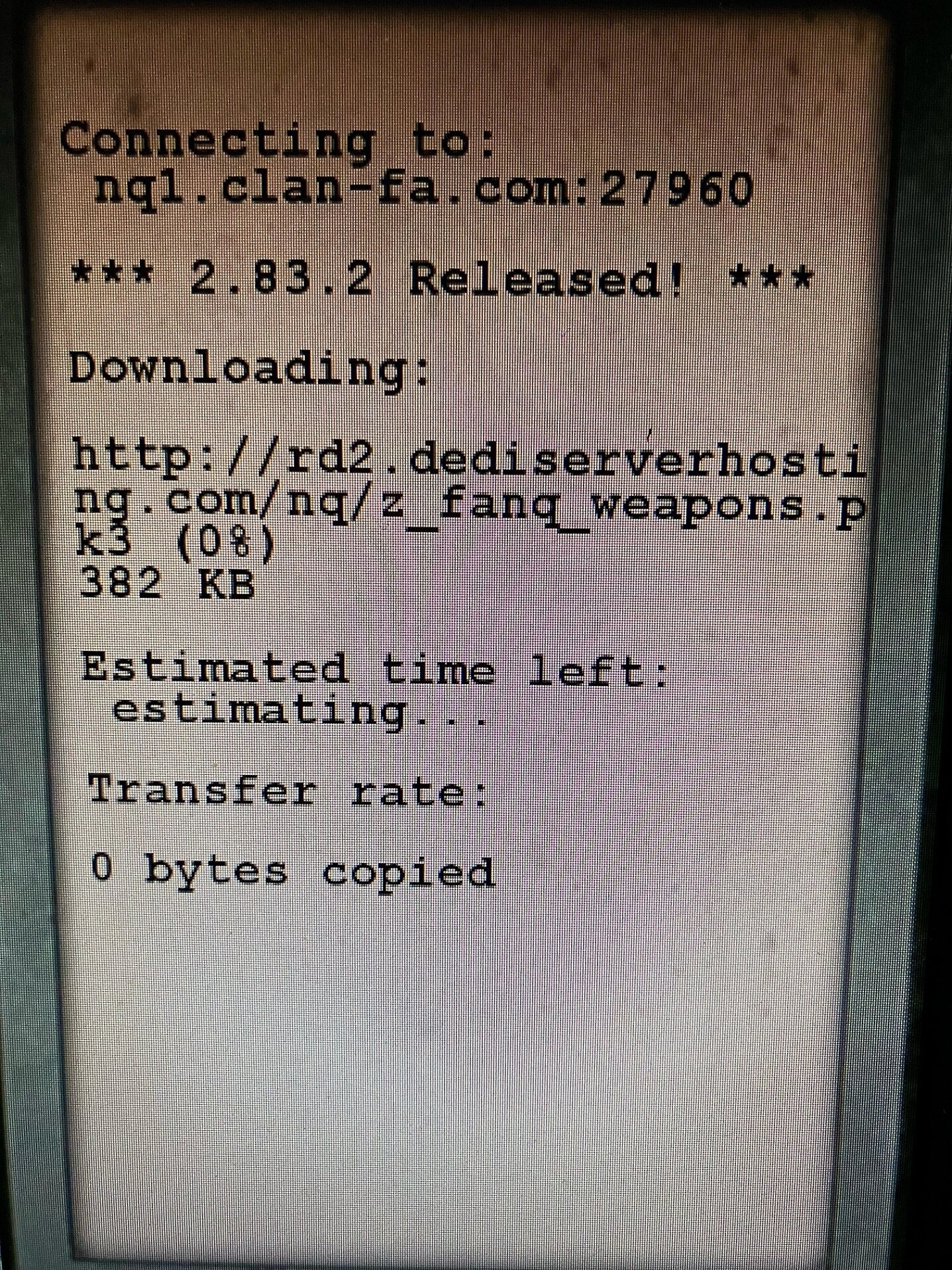

Loading worked! But only on the Beginer 1 server and only on 2.60b WinXp....
On Beginer 2 and NQ, and all servers Legacy - still throws out of games and does not load anything...(((

We tried to install ET from scratch for another person - he also can't download maps.
Could it be that the site https://dediserverhosting.com is blocked for connections from Russia?
i can confirm. there are no new file downloads from all FA servers. im also from Russia and i think the problem is with the server hosting

Yes, the server does not transfer files.
And there are no new files on this server to download them manually...
Please upload maps here so that they can be downloaded and played...
Yes, the servers do not allow downloading new maps for the game.
