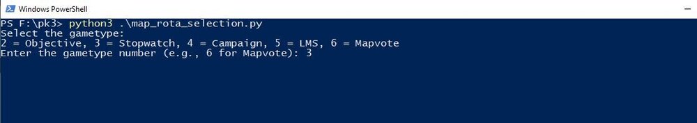

for example see screens

I don't think that will be used much. But if I understand you correctly you mean this right ?
This was a simple adjustment though.
The prompt:
print("Select the gametype:") print("2 = Objective, 3 = Stopwatch, 4 = Campaign, 5 = LMS, 6 = Mapvote") gametype = input("Enter the gametype number (e.g., 6 for Mapvote): ")
The validation:
if gametype not in ['2', '3', '4', '5', '6']: print("Invalid gametype selected. Defaulting to '6 = Mapvote'.") gametype = '6'
Config generation:
config_lines.append(f'set d{i} "set g_gametype {gametype} ; map {bsp_name}; set nextmap vstr {next_map}"')
