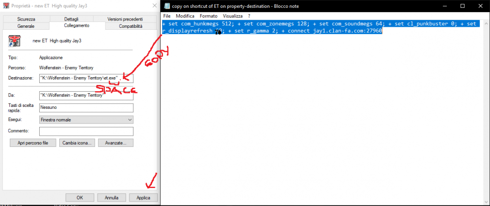

Guest Posted June 2, 2018 Share Posted June 2, 2018 this morning I created this little tutorial on how to activate these read-only commands through ET shortcuts as you can see by doing the test and writing the console commands the changes have been made successfully instead if we put them only in cfg, if you do the console test will return this message example: com_hunkmegs 56 default 56 latched 512 or this cl_punkbuster 0 default 1 read only many new guys play with com_hunkmegs 56 without knowing it, so they are limited, I can also recommend to everyone that the Punkbuster service has not worked for a long time, and the "FA" servers have a personal Anticheat, I believe that 90% of the guys they installed it, it's useless, in fact sometimes it provokes further lag, I personally when I install ET deselect the installer install Punkbuster service, I also add to the ET shortcut the entry + set cl_punkbuster 0, and check in the services that there is no Punkbusterservice .exe running, if I find it, it will be disabled forever. I state that my "pb" folder even deleted it, and the game works perfectly. Also to avoid overlaps of cfg due to the various profiles and to the various mod I do not use any profile, in fact when I open ET, I see the screen where you have to create the profile, but I use the preset shortcut, then I skip that process without having to create it obligatorily, then in play I open the console and run the my cfg and use vid_restart, this way every time I'm 100% sure that the commands of my cfg are all active 1 Quote Link to comment Share on other sites More sharing options...

Guest Posted June 7, 2018 Share Posted June 7, 2018 copy the Mordecai.cfg file to the etmain create an ET shortcut a click with the right mouse button above the ET shortcut select properties go to the word "destination" after the path "C: \ Program Files \ Wolfenstein - Enemy Territory \ et.exe" press space once and paste the following command line and press apply - close ---------------------------------------------------------------------------------------------------- + set com_hunkmegs 512; + set com_zonemegs 128; + set com_soundmegs 64; + set cl_punkbuster 0; + set r_displayrefresh 60; + set r_gamma 2; + connect jay1.clan-fa.com:27960 ----------------------------------------------------------------------------------------------------- now a right click on ET shortcut start as an administrator when you entered the server open the ET console with the \ key write / exec Mordecai and press the enter key in case some commands in the console ask for vid_restart type / vid_restart and press the enter key now you can play Mordecay 1024x768 75 hz cfg by Lenovo Mordecay 1366x768 60 hz cfg by Lenovo 2 Quote Link to comment Share on other sites More sharing options...
