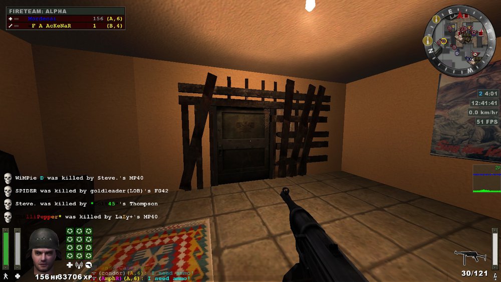

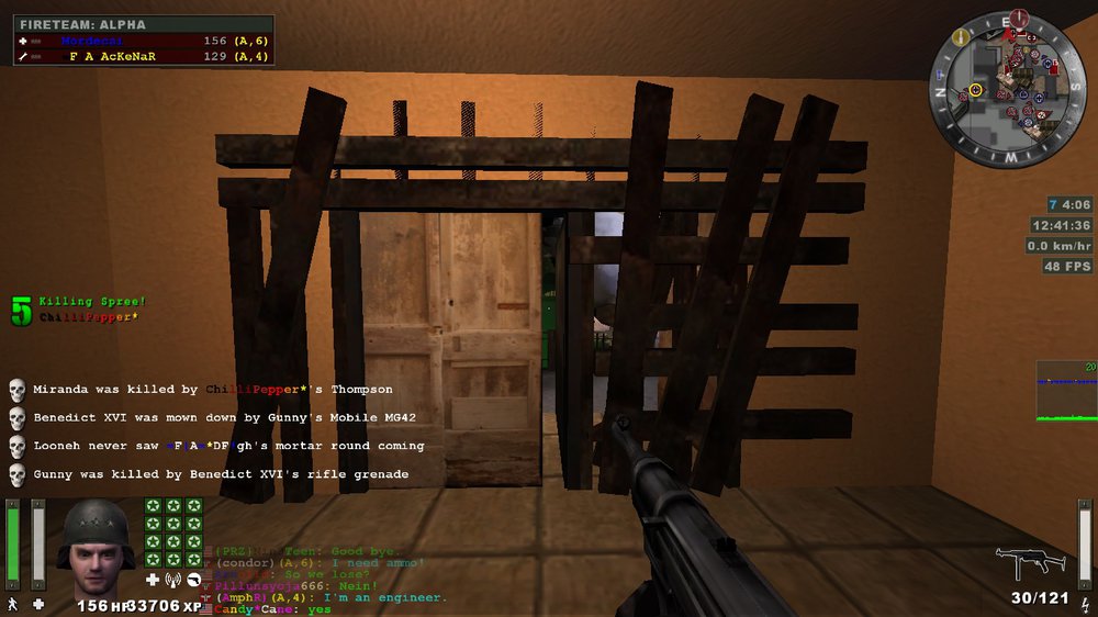

Axis get a massive advantage over Allies with this bug, it is done by planting a dyno in back door and then building materials, that naturally enable whenever main door is blown up.
Neither team can get in or out whenever this is performed, it is fixed by blowing this up with dyno, like it should me done normally, but Allies Cv Ops can´t get someone in for objective.
This glitch should be fixed soon.

It is an issue that has been known for years. Im not currently capable of watching your demo but Ill assume you do it the same way that I know.
The problem seems to be that the windows and door of the little room holding the construction parts get blown up by the dynamite that allies plant instead of the event of the walls breaching (dont know if eventhandling is possible like this in ET but it seems like spaghetti code to me). However unlike the main entrance itself the little room can get blown up by dynamites from either team. So if anyone wants to fix the mapscript issue my best guess is to either completely edit on which event the room gets opnened, or make it so that only allied dynamites have an effect on the room

I've had a *very* quick look at it and the easiest fix would be of deleting the constructible barrier. So when allies destroy labdoor axis will have a harder time defending.

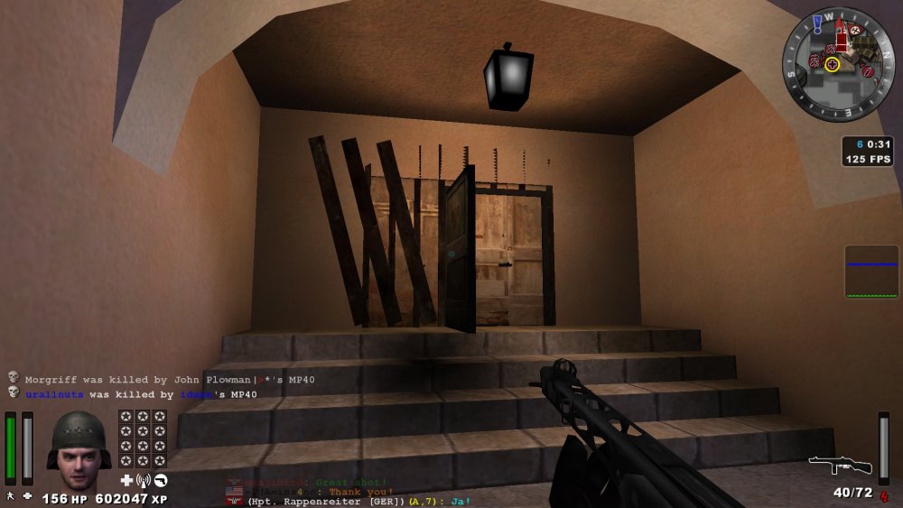

Fixed it. Problem was that the constructing trigger for lab reinforcements weren't hidden at start of map. Changed it so that it is hidden at beginning and comes available after labdoor has been destroyed. U can still destroy the innerside of lab with axis dyna but doesn't affect gameplay since glitch won't work anymore.

I think we had the same issue recently on Beg2.
@K3rmit Since this topic is 2 years old, maybe we lost the fix on the server or it's not there anymore (script file uploaded by Smiley above).

It is hidden, but you can still build it ..

Yeah, the map error is still there.  If you see anyone uses it, please follow this rule.
