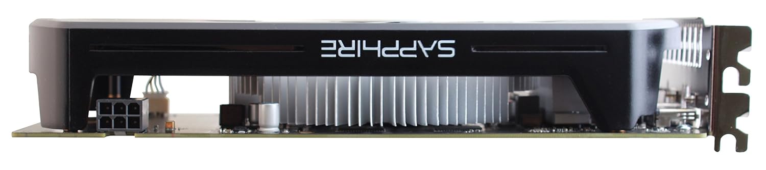

I got the Sapphire Radeon 560 RX Pulse 4GB GDDR5
Not the nitro.
Anyway, just take out the battery ?
Because my Bios is F12 already
but I wonder about the GPU.. the one I've mentioned.
Sapphire Nitro AMD Radeon RX 460 4G D5 4GB GDDR5
Hence our confusion. Either way, I still see a power connector on that.
I'm sorry but something just isn't adding up.

I dont the the pins needed in my GPU

https://www.reddit.com/r/Amd/comments/6c9ilg/finally_a_rx560_without_piwer_connector/
here's the topic which you can see there are several GPUs without the psu pins
That's an MSI card. :P Vendors like MSI, Sapphire, EVGA all decide the features they want (cooler, power, ports, factory overclock, etc) based on the reference model. Same model, different card.
But yes, I see that some variants of the 2GB model don't have the pins. Photos show the pins, but it looks like they released a second revision since the card came out.
Card can't be fixed, but can be exchanged. Hopefully the replacement works, I know it really sucks to have to RMA something so early.

If neither of the cards had power pins, then it's probably that your PCI-e slot doesn't supply enough power. The standard is only 45w if I remember correctly. So your mobo isn't faulty, it's just meeting the standard for PCIe slot power consumption.
If one of the cards did have additional power pins, then you might have a problem... but yet your current/old GPU works fine- which is odd.
