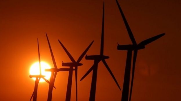

_97126063_windturbine.jpgImage copyrightPAImage captionThe growing use of renewable power might mean more attention from hackers, warn security experts
It is not just long-established elements of power grids that are vulnerable to attack. In another talk at Def Con Dr Jason Staggs from the University of Tulsa presented work he had done on the security of wind farm networks and turbines.
"The increased reliance on renewable energy sources will draw attention from attackers for all kinds of reasons," he said.
He added that his work revealed weaknesses in the hardware used to manage wind farms and in the software that allows them to be managed remotely.
In many cases, he said, it was "trivial" to get access to the control consoles and management systems used to keep turbine blades spinning. Poor internal controls meant an attacker that got physical access to one turbine tower could inject software and infiltrate an entire network of wind farms, he said.
"These networks are extremely susceptible to attack," he said.
If an attacker triggered turbines to shut down it could cause real harm to their drives, brakes and blades.
An hour of downtime on a relatively small wind farm would cost a power firm up to $30,000 (£23.250) for every turbine that stopped turning, he said.
He urged operators of wind farms to take security more seriously and put in place measures and controls that limit the impact of any intrusion into the control systems.
