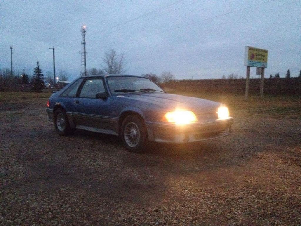

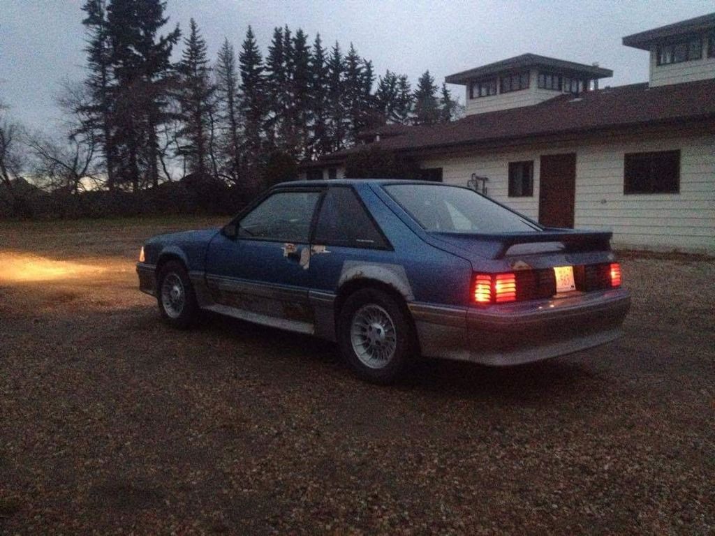

Here is the motor from my last foxbody. A 1991 vert. The first two picture is when I got it then the rest are after me tinkering with it.

And here are a few of the work i did to it.
