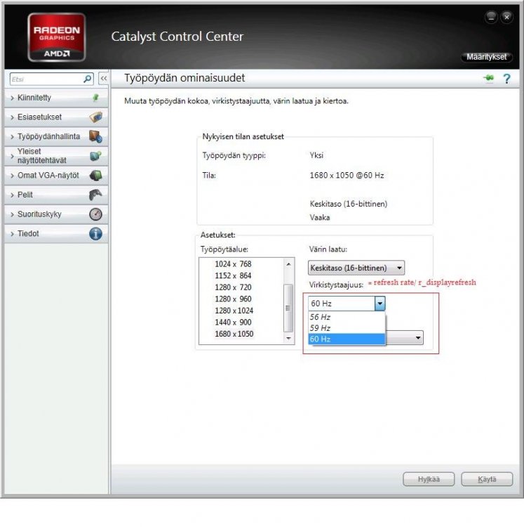

Btw does screen support 75Mhz? Usually it doesn't and will cause issues, so check that before adding in command line.

I have to disagree on that. Simply, because your screen should also support the higher values (check from gpu settings, pic below). Normal flat screen supports 60 hz, then if you buy more expensive one, it can go up to 144 hz. It is a huge advantage imo.

maybe google translator, he was wrong, and you did not understand that I'm saying your own thing
what I mean is this:
better to have the lowest resolution that guarantees the highest displayrefresh that the monitor supports
I use a TV even and not a monitor, because I see it better being 32 inches,
mine reaches a maximum of 1366x768 60hz,
but if I use it at 1024 x 768 I get 75hz, and increase my fps, as well as being more stable without wobbling the view

What he wants to say is if you change your resolution, and get it lower, you can OC your monitor refresh rate. i get 75hz max at any resolution till 1024*576 (16:9) or 1024*768(4:3) with my 60hz on 1920*1080.
