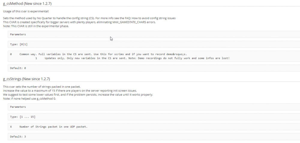

If it can be turned of server side, why bother with it, what is it used for ?
The idea behind it was to improve map load times and tbf for the most part it does do that but your talking a second or two if that. Given todays broadband and computer speeds its not really needed IMO but i think its on by default, so if server has had issues with crashes, which it has with so many players of late there is a good chance its been put on by default rather than server admin turning it on.

No that's not true. It helps with config string aka max gamestate chars kick.

Please try now - i increased the value to 10 from 6. If even 15 doesn't resolve it - we will make it player count based.

We enabled it back after 2 to 4 times, massive players got auto kicked because of max gamestate chars.

I know that the cs_method sort out the config string, and removes all informations that aren't necessary at a precise moment, keeping the config string below 16000 bytes, because over that, all ET clients crashes and get disconnect (not the server).  It's like a tool to "free the RAM" if you know what I mean.
For what I remember when it is enabled, the client needs to have a sort of communication with the server to synchronize the data's.
When you have a sort of bad connection (for example with restricted NAT) or poor upload performance, the "handshake" can fail as in your case.

Changed to 15 from 10. Let's monitor now. Let me know if you face the issue again.
