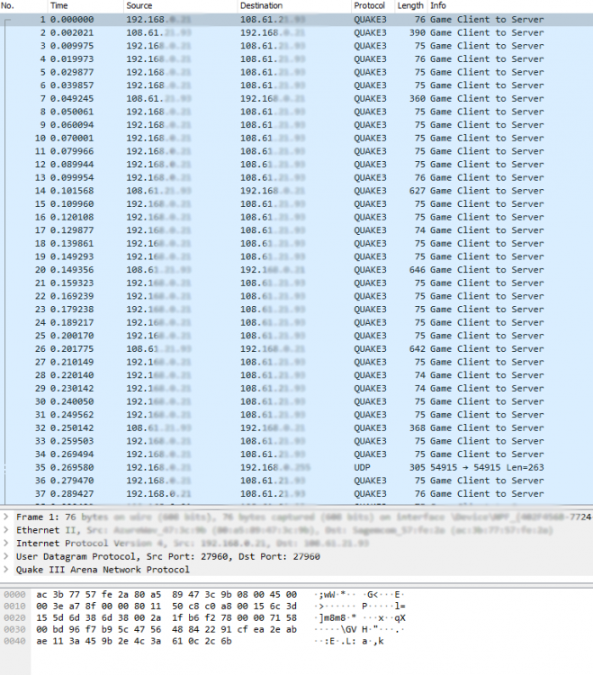

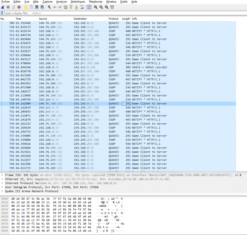

GHARIB Posted May 15, 2020 Share Posted May 15, 2020 (edited) Hey Mate! I had the same problem few months ago, and fixed it mainly with disabling Netwok discovery I took screenshots of network traffic with network discovery enabled, and disabled (it will show how what you explained is SO true ) Protocol QUAKE3 is for enemy territory frames Protocol SSPD is for Network discovery frames WIth SSPD SERVICE enabled (network discovery service) i got spikes of ping (SPIKES OF PING = LAGS) You can see that almost every Enemy Territory frame (QUAKE3), there is somes SSDP FRAMES - it can be 4 or 5 SSDP frames every 100ms (so up to 40/50 SSDP FRAMES every second , inducing on disrupted traffic (lag)) And now if Network discovery is disabled, ping is clean, there is only QUAKE3 frames Thank you @bubblehash , and good job for the tutorial! Edited May 15, 2020 by GHARIB 2 1 Quote Link to comment Share on other sites More sharing options...

Snuffs99 Posted May 15, 2020 Share Posted May 15, 2020 1 hour ago, bubblehash said: @GHARIB - Spot on dude! It's almost like you're a network engineer or something I just wanted to add that it looks like you've got that view filtered, but the same level of interruption traffic also happens on the IPv6 address space. Realizing I had completely ignored a parallel network stream in my optimizations was an "Aha!" moment in squashing this behavior. First off nice tutorial and well put together. I don't think the wireshark view is filtered on GHARIBs post mate, thats what mine looks like on WS too once connected to a server..... once all the background shite is stopped and your connected to an ET server that is more or less exactly how it should look. IPv6 is of no use to me atm so I've currently got all IPv6 turned off completely, plus when/if using a VPN if IPv6 is enabled it can cause really slow host resolves and general HTTP browsing can be reallllly slllooooowwwww. Also @HipKat If like me your PC is the source for all other equipment in your house etc to connect to for PLex etc then its advisable to make sure your PC or device is given the same network IP from your router each time if not already set. Just makes it so easier to share when you know the IP of the source is constant. 3 Quote Link to comment Share on other sites More sharing options...
