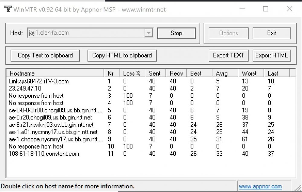

Just to compare, this is mine. What are the No Response From Host, btw,  and how does that affect network traffic?

Those hops do not respond to your ping requests, idk why and how they do it, but it shouldn't have much effect afaik as long as the packets sent from pc/ or the first hop should be equivalent to the last one? Meaning that packet are reaching the server ,but those same packets don't reach the in-between servers which gives you no response from host. That's my understanding idk if it's right.
Your first hop has average latency of 5 ms - that's fucked up and worst 13 ms is bad as well. Other then that you need to run winMTR for 100 packets.
49 minutes ago, daredevil said:
Your first hop has average latency of 5 ms - that's f***ed up and worst 13 ms is bad as well. Other then that you need to run winMTR for 100 packets.
The hop to my router could be jacked because it's an old Ethernet cable that runs outside my house form the room with the modem to the room with the desktop and the casing is probably getting rotted
