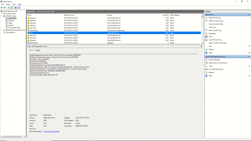

Ahh so its windows telling you its crashed?
I assume your running it as admin?, it doesn't have to be compat mode or anything but does have to run as admin under windows 10 otherwise it will crash. Bit odd it doesn't crash with NQ though?
Not sure how PC savvy you are but if your running ET as admin already and its still crashing then check the event log and see what reason its giving....to access event logs in search box type event and event viewer should show, click that then click the arrow by windows logs and click applications.....check the errors and see if any relate to ET and what reason it gives, if any (log will have information (circle with i in), warnings (yellow triangle with exclamation) and errors (red circle with exclamation)) .

I am putting some log results here  for future searchers with the same problem(s).
Exception Code: 0xc0000005
Event ID: 1000
Task Category: (100)
