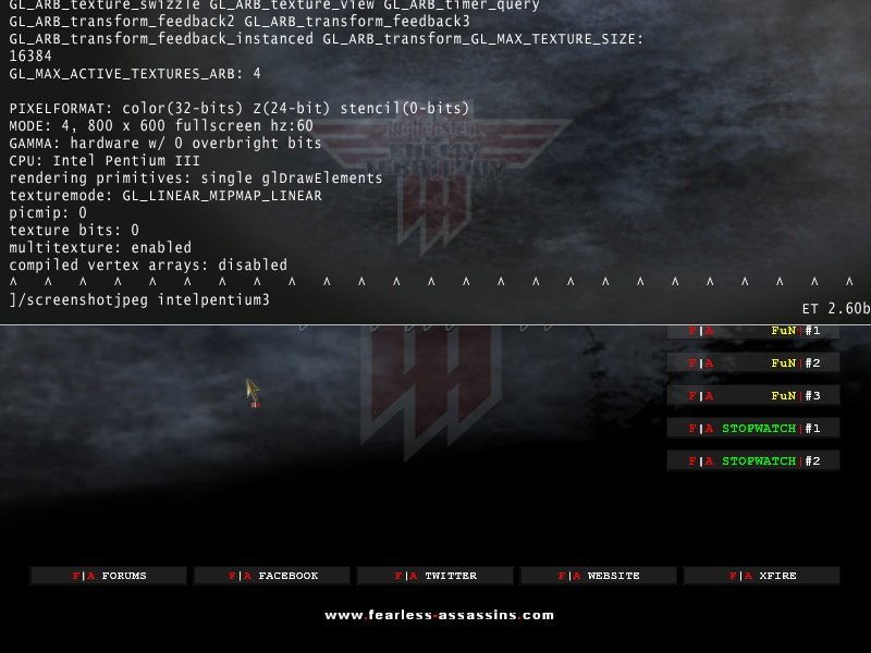

0 DoubleDragon Posted September 25, 2019 Share Posted September 25, 2019 Direct X will apply a third party binary for video buffers that came out when the game was released in Windows XP Sp1 reinstalling this driver will update the required binaries with windows update for installed software He may have to disable the video driver completely and shut down the service for his video device driver as well if it is related to video buffers and run directly from on board But as my first post suggests it is reading it as a Pentium 3 not a 9th Gen and he is probably having compatibility issues that windows 10 can't resolve thus suggesting direct x may be required Windows 10 does have DX 11+ by defalut but ET was designed for DX 9C and below he is possibly incompatible through hardware design with the board as well per video card specs He's got to reverse engineer the setup to get it compatiable Or he's going to have to make a video kernel or use a third party driver that is compatible with the game not the motherboard to run the video card buffers There can be a lot of possibilities for this to go wrong and the most important one is the processor not reading correctly during console load time when game starts Did the chipset get updated before the drivers were installed that can also cause C++ to become unstable in the WIM 1 Quote Link to comment Share on other sites More sharing options...
0 ElEl Posted September 25, 2019 Share Posted September 25, 2019 41 minutes ago, DoubleDragon said: But as my first post suggests it is reading it as a Pentium 3 not a 9th Gen and he is probably having compatibility issues that windows 10 can't resolve thus suggesting direct x may be required This has never been an issue. It says Pentium 3 for my CPU, an i7 4790k. The game's old and all it knows is old CPUs. The problem is most likely his graphics card. Quote Link to comment Share on other sites More sharing options...
