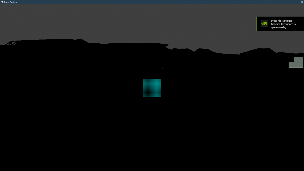

Hi, I was on Minis Tirith before, I ended up changing a setting with hunkmegs or something, everytime I try join server now my games just broke, i cant get into a game, i tried reinstalling ET, using PK3 cleaner etc. Nothing is working.
Ive tried installing random cfg like mAus cfg but this is what my screen looks like in game.
I dont understand whats happening, it looks like a PK3 issue, i have just recently updated to new NVIDIA drivers, but i was playing fine while they was updated? Maybe its a hunkmegs issue, ive tried loads of dif settings but cant fix? Cant remember what I had it set too before i messed with it.
Any help is appreciated.
Thanks

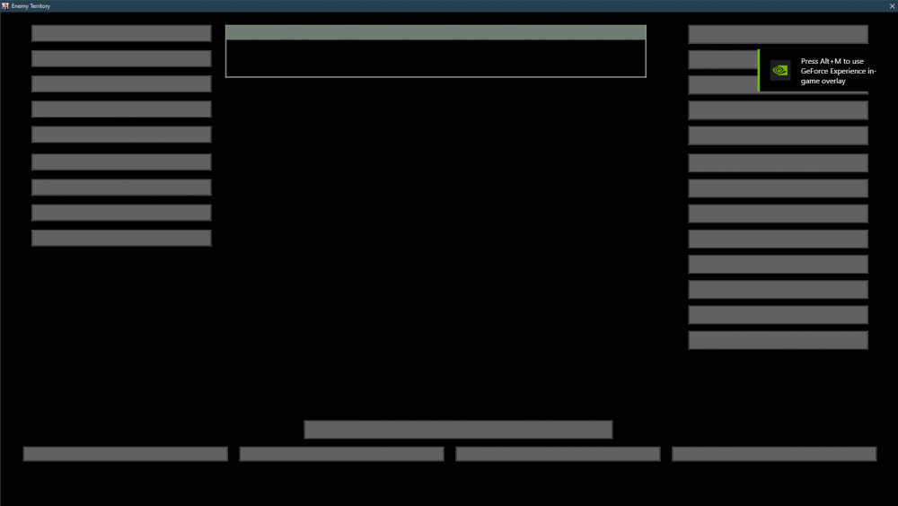

EDIT: Little bit of context if I load ET, without clicking anything menu looks fine, its just as soon as i click FA beginners for example, the whole right section on the loading section is blacked out!

First try do /cvar_restart and then /vid_restart to see if that fixes the issue. If that doesn't fix it then it's likely a problem with the driver update, try rolling back your drivers to the last version that worked.

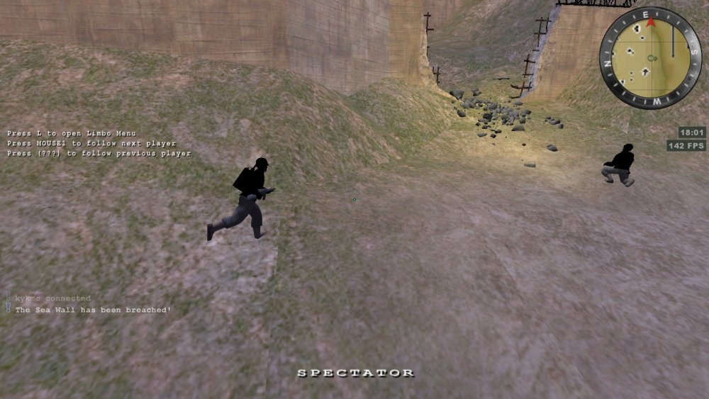

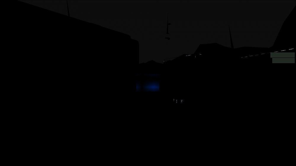

Literally when i exec my cfg it looks like this now, literally looks like a half wallhack or something! I dont understand, its the same cfg i always used, any idea on the CVAR thats breaking this?
Could you upload your config, I'll take a look. I think it's a problem with your graphics drivers though, maybe a rollback wouldn't be a bad idea just to test if it fixes it.
