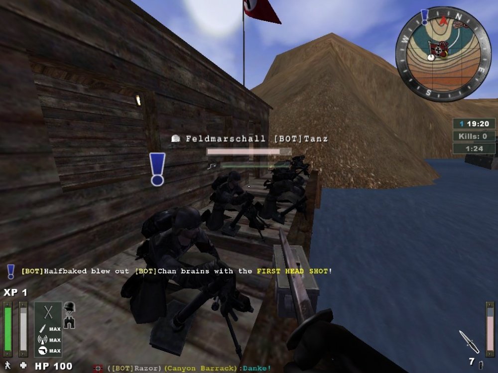

// No Quarter 1.2.9
//* Omni-Bots * //
set Omnibot_Enable 1
set Omnibot_Path "./Omni-Bot ET/Wolfenstein - Enemy Territory/omni-bot"
set Omnibot_Flags 0
set g_csMethod 0
set g_csStrings 3
set g_ForceCvarFile ""
set g_simpleBullets 0
set g_killerLockTime 5
set ip_max_clients 3
set g_friendlyFire 0
set g_adrenaline 32
set g_noAttacklInvul 1
set g_weaponItems 7
set g_missileHealth 5
set g_missileSpeed 0
set g_bulletReflect 0
set g_falloff 1
set g_missileGravity 2
set g_fastBackStab 0
set g_realism 32
set g_announcer 255
set g_flushItems 1
set g_multikillTime 2500
set g_mortarBBox 0
set g_weaponScriptsDir ""
set g_spectator 0
set jp_insanity 1
set g_unlockWeapons 1
set nq_War 0
set g_throwDistance 75
set g_dragCorpse 1
set g_dropObj 1
set g_slashkill 0
set g_spawnInvul 3
set g_dropAmmo 1
set g_dropHealth 1
set g_shortcuts 1
set g_shrubbot "shrubbot.cfg"
set g_dbDirectory ".\nq"
set g_skills 16
set g_msgs 30
set g_msgPos 1
seta g_msg0 ""
seta g_msg1 ""
seta g_msg2 ""
seta g_msg3 ""
seta g_msg4 ""
set g_censor ""
set g_censorMuteTime "120"
set g_censorNames "hitler,osama"
set g_censorPenalty 48
set g_intermissionTime 35
set g_intermissionReadyPercent 75
set g_inactivity 180
set g_spectatorInactivity 0
set g_mapScriptDirectory ""
set g_canisterKick 80
set g_canisterKickOwner 0
set g_classChange 0
set g_constructibleXPsharing 1
set g_doubleJump 0
set g_doubleJumpHeight 1.4
set g_shove 150
set g_shoveNoZ 0
set g_asblock 0
set g_fear 2000
set g_goomba 0
set g_weapons 8
set g_goombaFlags 25
set g_headshot 0
set g_playdead 1
set g_medics 65
set g_realHead 1
set vote_limit 3
set vote_percent 66
set vote_allow_antilag 0
set vote_allow_balancedteams 0
set vote_allow_comp 0
set vote_allow_friendlyfire 0
set vote_allow_gametype 0
set vote_allow_kick 0
set vote_allow_map 0
set vote_allow_maprestart 0
set vote_allow_matchreset 0
set vote_allow_mutespecs 0
set vote_allow_muting 0
set vote_allow_nextcampaign 0
set vote_allow_nextmap 0
set vote_allow_poll 0
set vote_allow_pub 0
set vote_allow_referee 0
set vote_allow_restartcampaign 0
set vote_allow_shuffleteamsxp 0
set vote_allow_shuffleteamsxp_norestart 0
set vote_allow_surrender 0
set vote_allow_swapteams 0
set vote_allow_timelimit 0
set vote_allow_warmupdamage 0
set team_maxIsPercentage 0
set team_maxPanzers -1
set team_maxMortars 16
set team_maxRifleGrenades -1
set team_maxMG42 -1
set team_maxFlamers -1
set team_maxShotguns -1
set team_maxVenoms -1
set team_maxLMGs -1
set team_maxScopes -1
set team_maxLandmines 10
set team_artyTime 10
set team_airstrikeTime  10
set team_panzerRestriction 100
set g_XPSave "15"
set g_XPSaveDirectory ""
set g_XPSaveMaxAge 86400
set g_XPDecay 0
set g_XPDecayFloor 540
set g_XPDecayRate 0
set g_maxXP 10000
seta skill_lightWeapons "0 0 0 0 0 0 0 0 0"
seta skill_battleSense "0 0 0 0 0 0 0 0 0"
seta skill_soldier "0 0 0 0 0 0 0 0 0"
seta skill_medic "0 0 0 0 0 0 0 0 0"
seta skill_engineer "0 0 0 0 0 0 0 0 0"
seta skill_fieldops "0 0 0 0 0 0 0 0 0"
seta skill_covertops "0 0 0 0 0 0 0 0 0"
set g_countryflags 0
set lua_modules ""
set lua_allowedModules ""
set nq_scriptMode 7
//* Map voting CVARS (don't set if you don't use map voting* //
set g_mapVoteFlags 0
set g_maxMapsVotedFor 6
set g_minMapAge 3
set g_excludedMaps ":fueldump:"
set g_resetXPMapCount 0
// MISC SETTINGS
set g_heavyWeaponRestriction "100"
set g_antilag "1"
set g_altStopwatchMode "0"
set g_autofireteams "1"
set g_complaintlimit "6"
set g_ipcomplaintlimit "3"
set g_fastres "0"
set g_friendlyFire "0"
//set g_gametype "4"            // Game type should be set from map rotation script
set g_minGameClients "8"
set g_maxlives "0"
set g_alliedmaxlives "0"
set g_axismaxlives "0"
