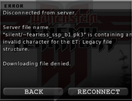

Today I updated ETL to 2.76 (yaay finally). Tried to change mod/connect FA server - it deleted all custom FA pk3 files automatically. Now I'm unable to join HC for example, showing me this error:
It seems that you need to remove all ~~~ from your pk3 names. Well, that's gonna take a while I guess...

Someone needs to rename pk3's from ~~~~~fav.pk3 or other characters even with copies of the files in place accordingly they aren't read.
Please look into this would like to use the updated version on the server.
