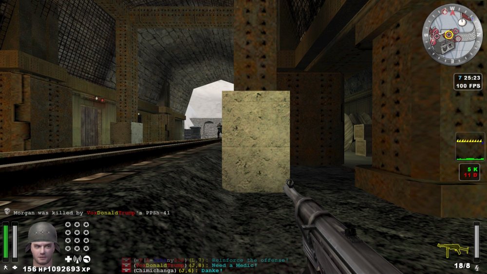

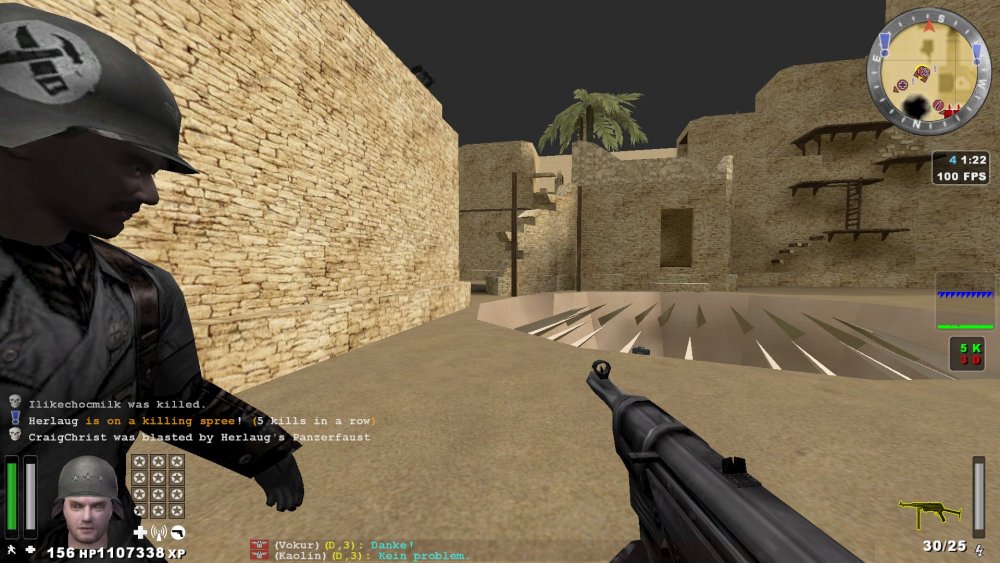

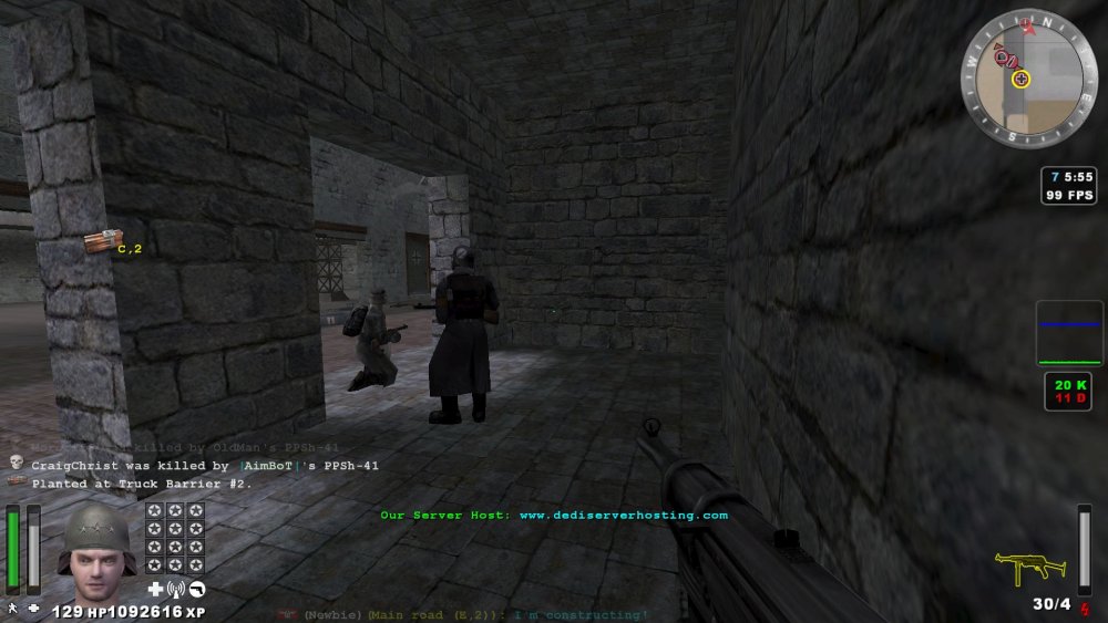

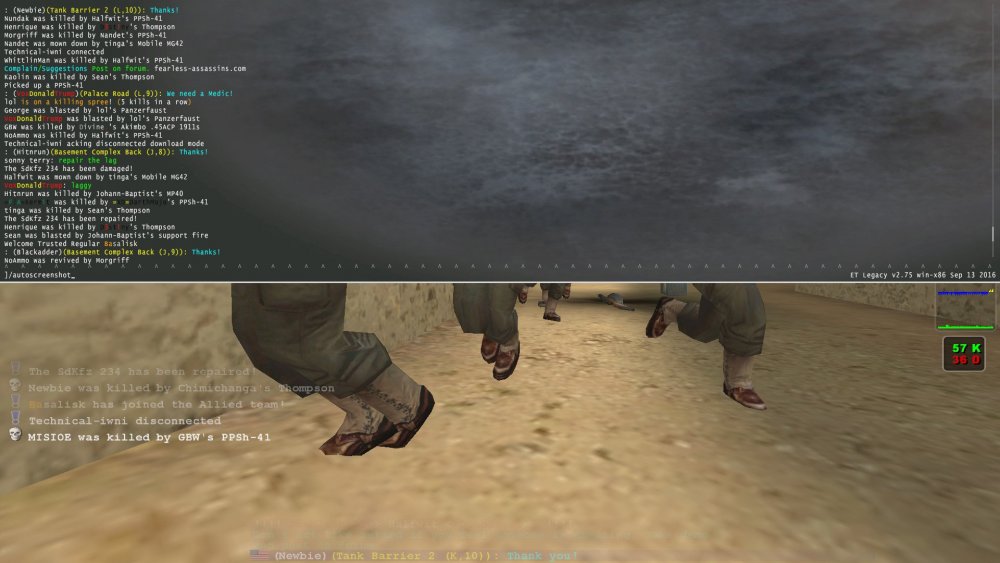

Beg 2 are very lagy today and pings jumping all the time, can someone check it out?
Normally my lagometer shows like this
today its like this
  • 0
Do you see the difference in lagometer? i.e. see your green line.  It's changing.
Can you please share winMTR of 100 packets with it in background when you experience lag?

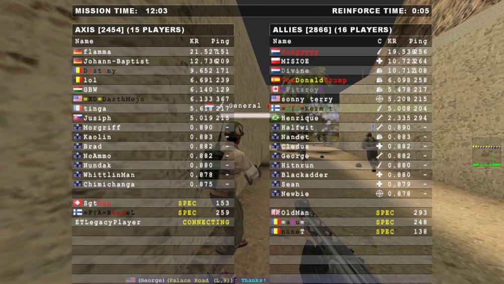

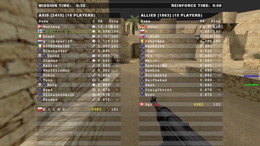

Yeah, I taked those while playing and had lag earlier today.  We played goldrush, supplydepot, teuthonia.. those was fine and no lag. When the school map started lag started..
The map should only add FPS lag or may be increase a ping by  +/- 10 - not more then that.  I did run mtr from server to your IP -

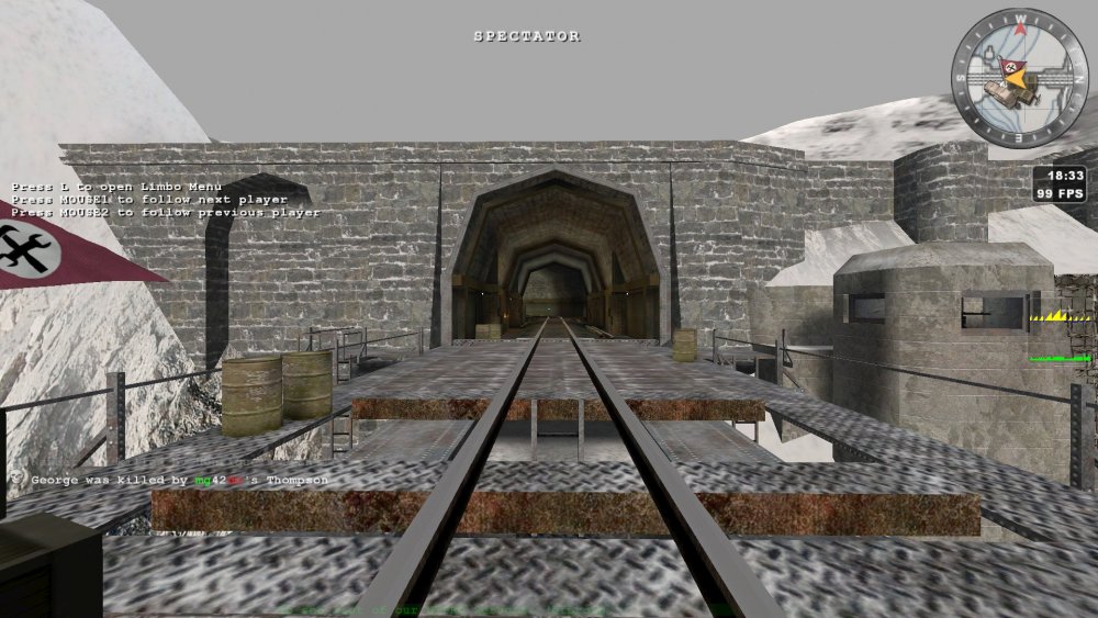

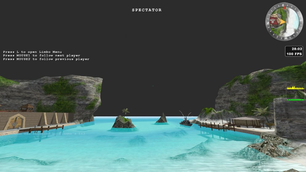

Can you tell me what these blue triangles on lagometer means?
  • 0
1 hour ago, K3rmit said:
Server runs fine now, dunno what happened.. Only on yesterday when I connect to server and Millenium falcon was going we had high pings, but there was only 5 min left so i didn´t pm you..
Does WinMTR show any differences? Yours look good. Modem/router firmware working properly, though there are some spikes. Seem infrequent enough though, as averages aren't too far deviated from best.
Could be the datacenter was getting hit hard with traffic, or they did/were doing some maintenance. I have one or two guesses- but just speculation, so won't mention them as to not derail/cause confusion.
Triangles on lagometer explanation (hopefully is accurate- been a long week and I'm exhausted... someone plz correct me if I'm wrong :P)
-Blue lines w/triangles is server side.
-Green line is client side.
For upper line/server side:
-Downward triangles indicate interpolation- this is ok. Triangles facing up indicate extrapolation- this is not so good. This is where FPS, snaps and other network settings come into play. Basically the server sends out 20 updates per second (20 snaps).
-In your SS above, your display is updating 100 times per second (100fps). In fact, you might notice that depending on your net settings, and/or the higher your FPS is, the larger the triangles.
For lower line/client side:
-Red is bad- means no snapshot sent to the server- which leads to extrapolation-- yellow on the upper line. However, there can also be yellow on the bottom line. This would be reverse but also bad scenario-- client didn't receive snapshot from server, or it was delayed.
-ET servers update at a fixed rate, clients don't. Clients depend on networking, system performance, etc. So to account for that (using your latest ss as an example), the game client needs to smooth things out to account for those differences in updates so you don't people warping/jerking all over the place.
-So in your example (you're running 100fps*, server is updating 20sps*), those triangles show your client taking 1 snapshot (snap), estimating positions of players, rockets, etc. and smoothing it out over 5fps.
*fps= frames per second, sps = snapshots per second (or snaps)
Edited by Xernicus
+estimating
  • 0
Your green line in lower lagometer graph is still higher compare to your normal - green bar height is always proportional to your ping to server.  So it seems during that time - your latency increased but since their is no packet loss - your upper graph - blue is perfect.
