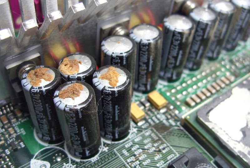

4 attempts to turn on your PC? Plus those wonky fans and lights... Shoulda thought of this earlier but I'd say you have bad caps- either on mobo or in PSU. Hopefully just the PSU. Give the one you have laying around a try. Should work fine.
Take a close look on the mobo for crappy looking stuff like this. Any bulges- even without them exploding- or crud on the PCB also means it's got to go.
