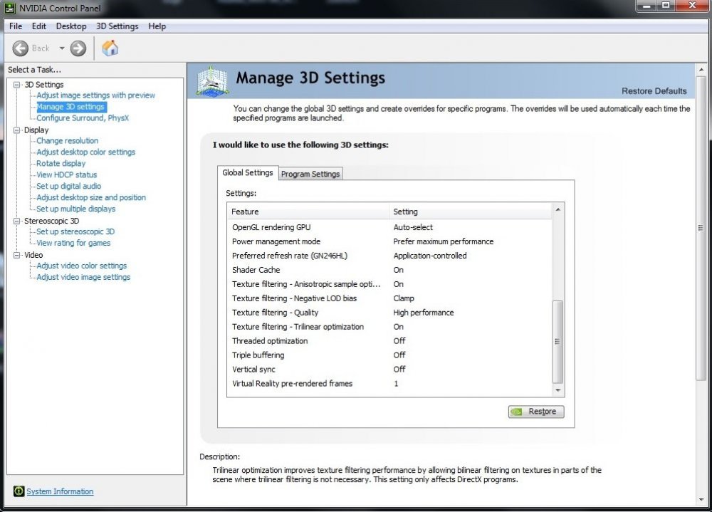

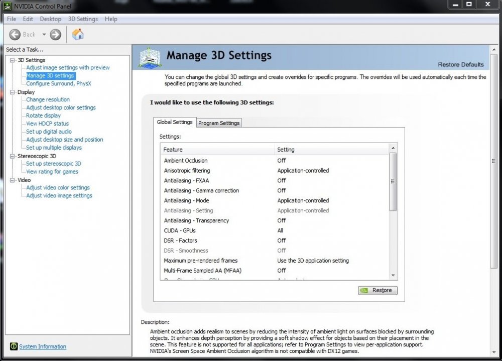

Have you seen this post for nVidia settings?
yes and i have the settings turned off/on as mentioned in this post.

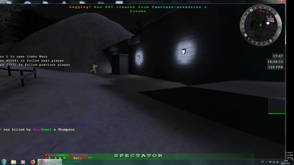

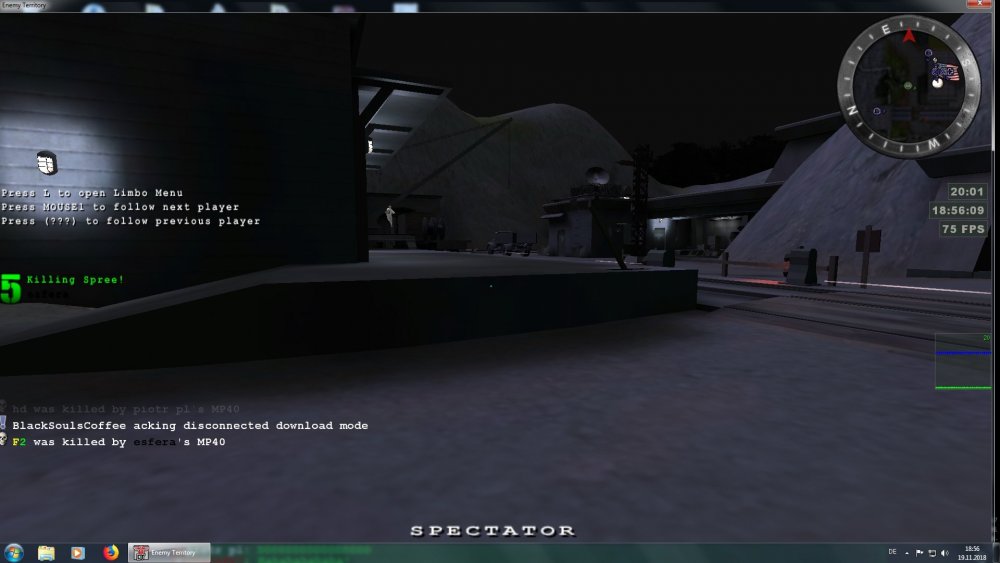

you might want to take a look at the attachments. i am almost at the same spot but as you can see i have 75 fps while looking at the stairs and 125 while looking on the ground.
