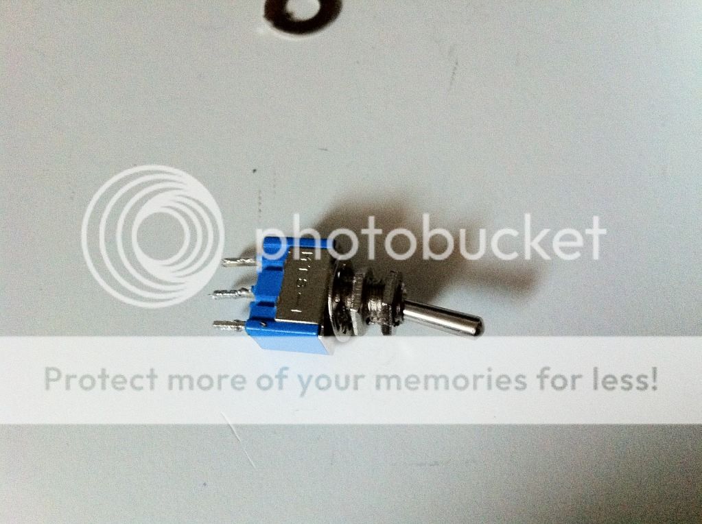

I decided to add a switch for each fan as well:
Posted Image

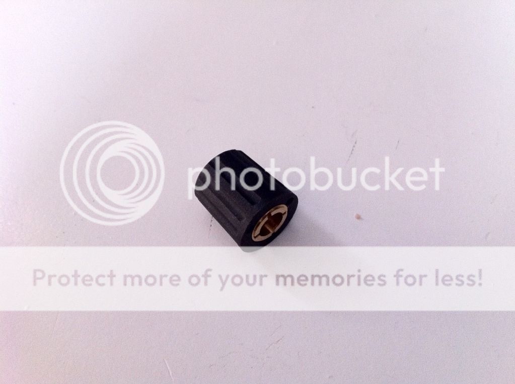

Cap for the potentiometers:

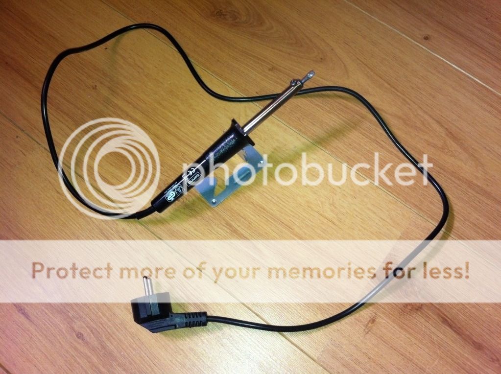

Soldering Unit:
Posted Image

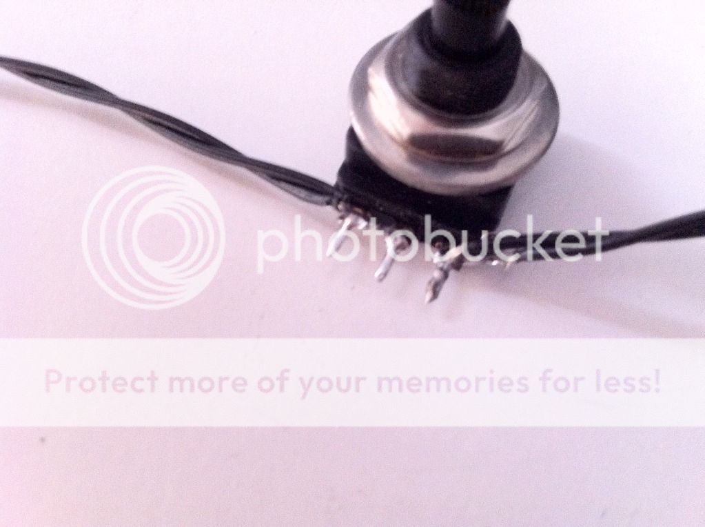

So now the actual work can be done. You want one wire that leads from the power supply to your potentiometer, then to the switch, and then to the fan (red wire). The second wire will lead from the power supply straight to the fan (black wire).
First solder a wire to the left and middle part of the potentiometer, this wire will be attached to the yellow or red wire from the PSU. A second wire is solder to the right side of the potentiometer, this wire will lead to the switch.

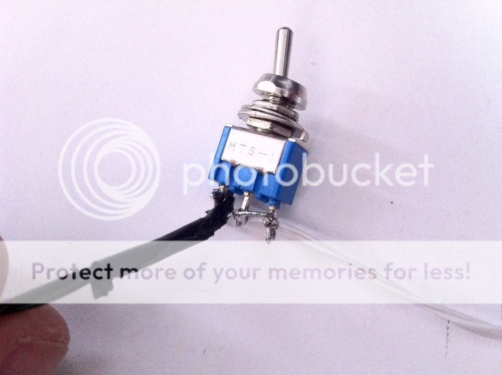

Second solder the wire coming from the right side of the potentiometer, to the left side of the switch. The white wire is then soldered to the middle part of the switch, this white wire will go to the fan's red wire.

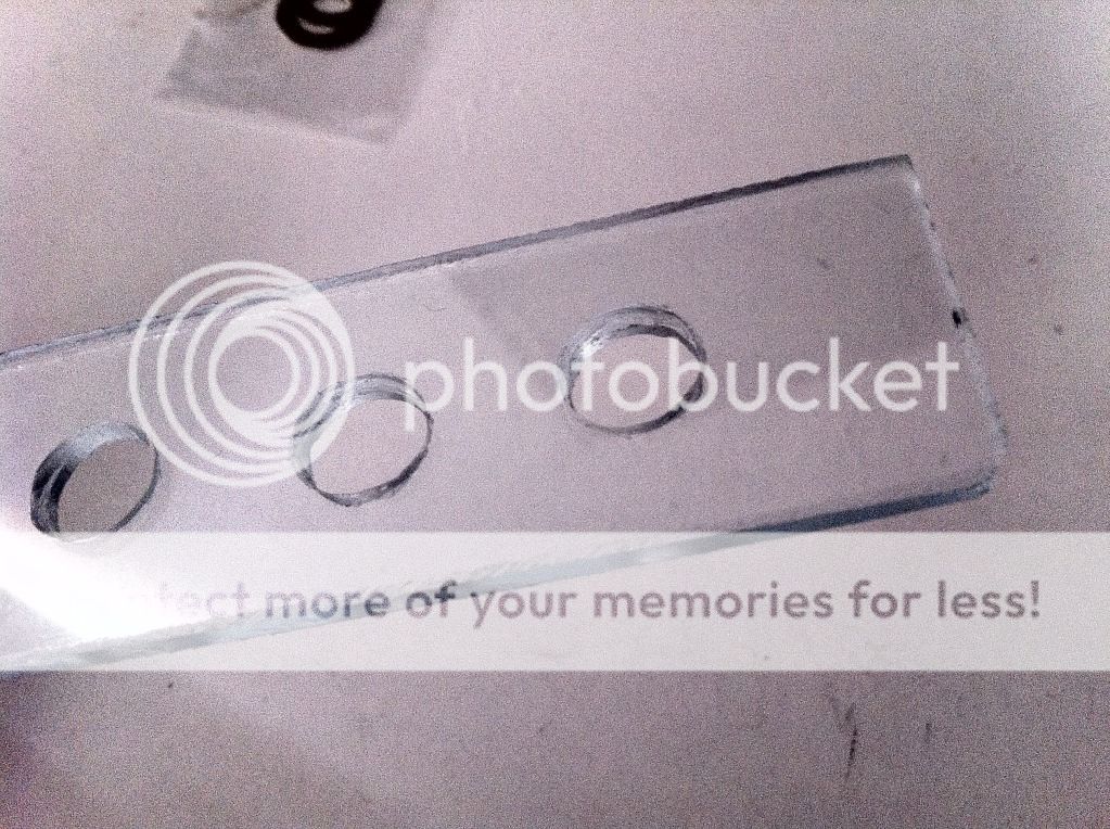

Plexiglass plate with holes drilled for the switches. Use drill bits that are made for drilling through metal.
Posted Image
Plexiglass plate with holes drilled for the potentioemters:
Posted Image

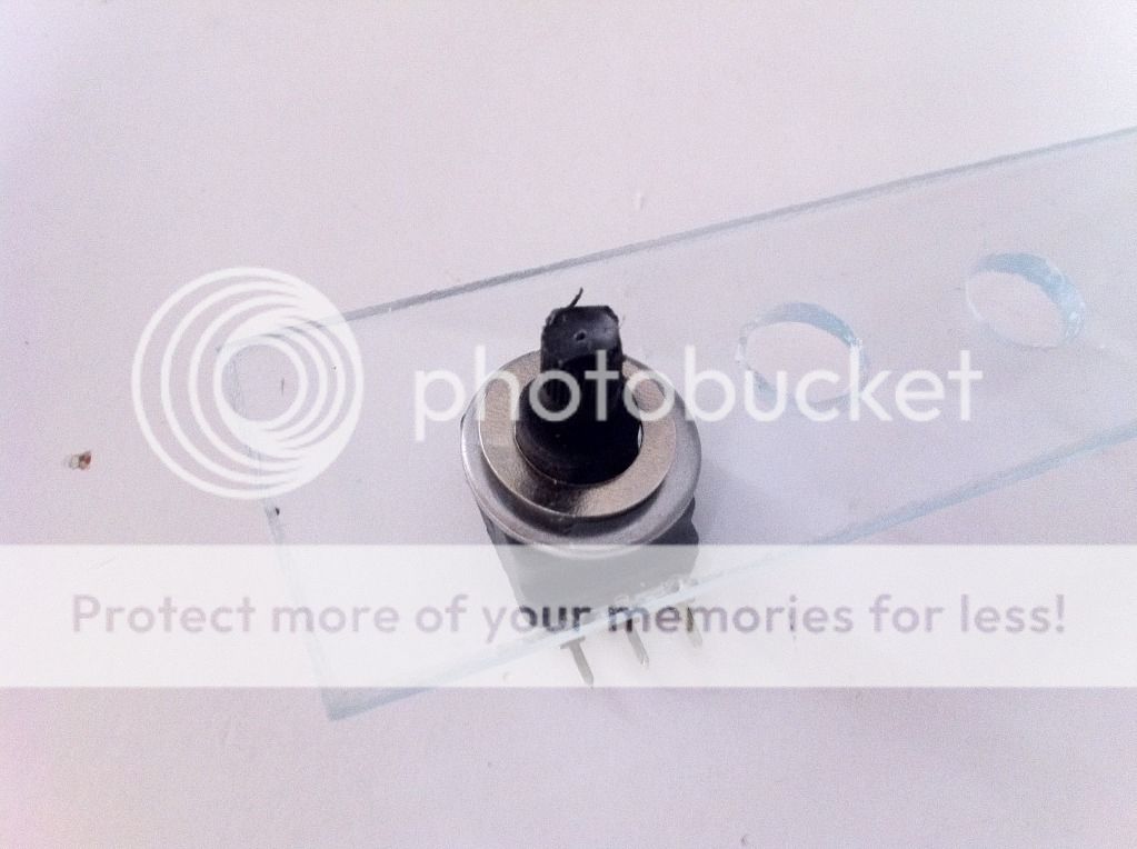

You can then screw in the potentiometers and switches into the plate, an example is show below:

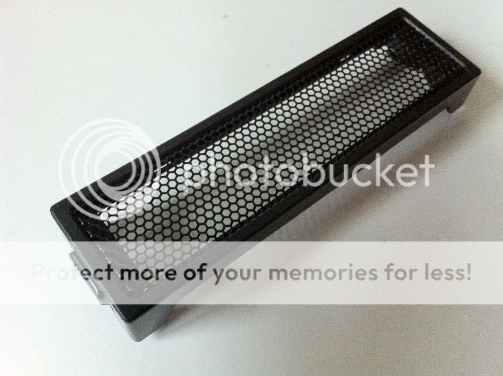

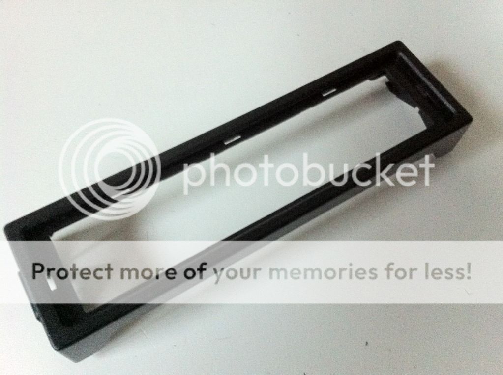

Next, on the front of my computer I have these plastic rectangular pieces that are easily removed.
Posted Image
Posted Image

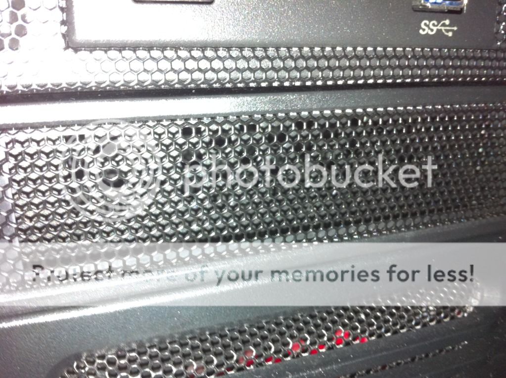

Once you take out the metal "fence" out:
Posted Image

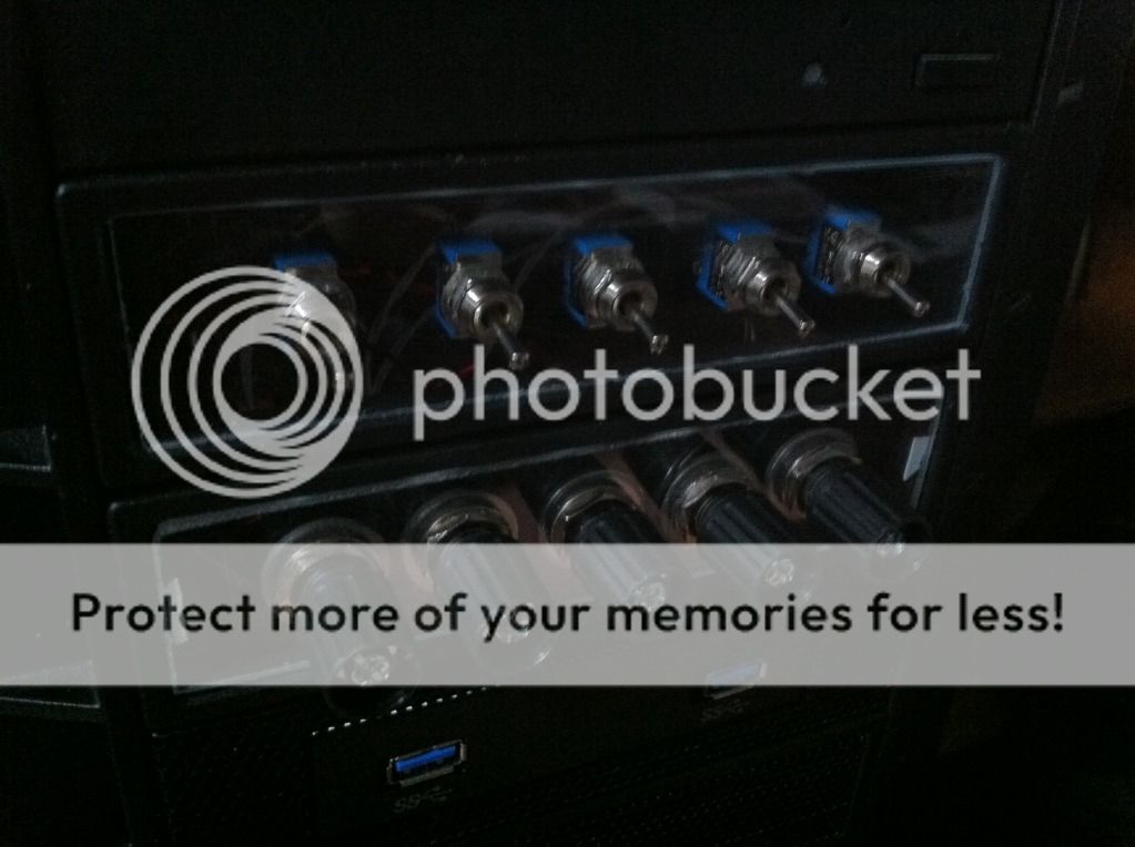

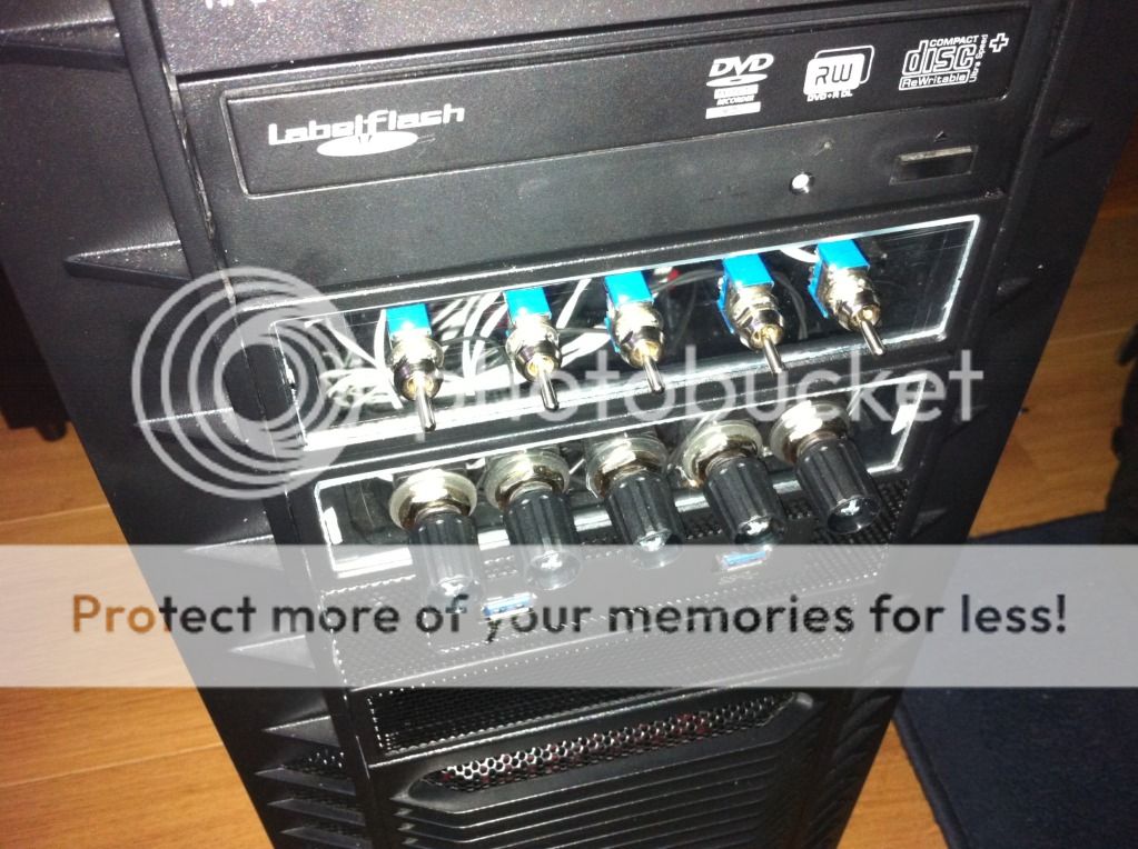

The plexiglass plates are then mounted inside the plastic rectangular pieces, you can use glue or two sided tape. Then it is possible to put the plastic rectangles, with mounted plexiglass plates, and the potentiometers/switches screwed in place, back onto the computer (all these switches are in the OFF position)
Posted Image
Posted Image
