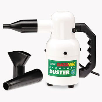

TulsaGeoff Posted January 21, 2013 Share Posted January 21, 2013 I have this thing and it works extremely well for cleaning out my PC. Make sure to do it outside. An air compressor with a sports ball inflate needle on it works great too. http://www.amazon.com/Metro-Vacuum-ED500-500-Watt-Electric/dp/B001J4ZOAW/ref=sr_1_1?ie=UTF8&qid=1358805099&sr=8-1&keywords=blow+vac Quote Link to comment Share on other sites More sharing options...
