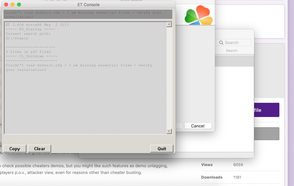

@RedBaird I use Wine for playing ET. So far when I try to install this program "et_demoview_1_4" program, I'm having issues. Not sure what's happening but here is the ss of what happens in the end of installing:
739716440_ScreenShot2018-12-04at00_51_56.thumb.png.8b15f166b98124af8609bd59703711a1.png
In Windows, I unzipped the .zip file and put the resulting ET_DemoView_1.4.exe into my ProgramFiles/ Wolfenstein - Enemy Territory folder.  From there, it should find all the files that it needs, including ET.exe , the default.cfg.  I made a shortcut to that .exe file and run it from elsewhere.
You seem to be executing the demoview in your Z: drive .  I that where you have ET installed? Your SS shows the program looking in z:\/etmain for its files. That "Z:\/", with slashes in both directions, looks odd.  Is that what you see when you run ET?
Looking inside ET.exe, it does contain the text-lines of
exec default.cfg
Couldn't load default.cfg - I am missing essential files - verify your installation?
It looks like DemoViewer is executing ET.exe, but ET cannot find its files in ETmain.  In windows it is not necessary to actually "install" the program.
