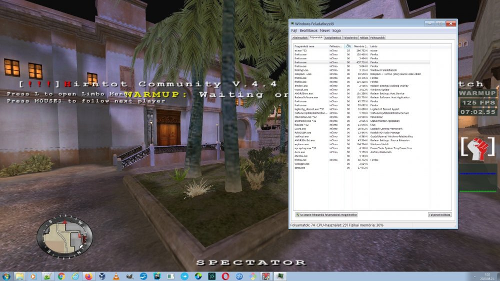

Guest inf3rno
On 1/4/2012 at 10:27 PM, Quovadis said:
So my gf just bought a new PC so she can get on ET with me .
Specs : Alienware M18x
Icore 7 2.00ghz
6gb Ram DDR3 1333mhz
Geforce 460m 1.5Gb GDDR5
So heres the problem, on ET she gets fps drop ( like a 0.5 sec freeze) even in 800x600 with low graphics.
It happens regulary every 3 seconds and fps always goes from 76 to 56.
I tried everything can't fix this issue. Could someone help me?
Same here ever since 2008-2010ish when I changed to Win7 from XP. I changed a lot of hardware and even ISP too, I could not figure out in a decade what went wrong. :S I just noticed that even when I host server I got FPS drops in every 2-3 secs. I have i5 4670k, rx 580 currently, they should be able to handle this game. Even my previous config should have been a lot more than enough, still I got constant input lag and relative low FPS compared to the hardware. I solved the tearing with 120Hz vsync, but I still got this lag with FPS drops, which makes gaming a lot harder than it should be. I am curious if anybody managed to figure this out. I found a similar post in reddit and they just solved it by using ET Legacy, which does not have it according to them. I am still curious what broke my ET carrier in half...
